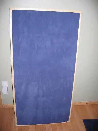

Airtight? Hmmmm. Maybe I did something wrong.
Anyway, here is what I did.
Got a bunch of 2'X4' 703 panels.
Got some cheap muslin fabric - dyed it blue for fun.
Cut the muslin to about 8 inches bigger on all sides than the 703.
Stretched the fabric slightly over the front of the 703, then used spray adhesive on the sides and around the edge of the back, and wrapped the fabric around.
Then I built a frame out of 1X4 pine with an interior dimension of 2X4.
Finally, I pressed the fabric wrapped 703 into the frame.
I'll even post some pics in a few.
Simple and cheap.
:D
the front.....

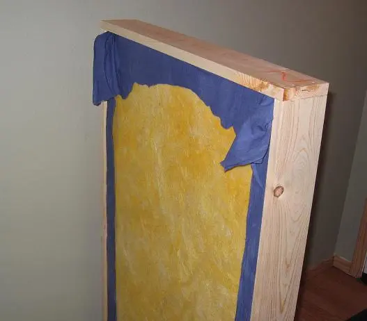

The back and side - I could of stained the wood and made them "prettier" I guess....
Does that work good taming the beast of the bass??? :D
