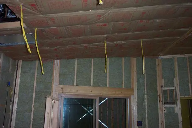

My control room ceiling is angled. The rise is one foot in 12... I think.
Its hard to tell, but there's a picture of it here:
https://homerecording.com/bbs/showthread.php?t=114536&highlight=Ceiling
The main thing is the supporting cross beam; that really needs to be engineered for the span. That span is about 18'.
So, you frame your walls up all at the same height. The cross beam rests on top of the wall studs, near the rear of the room. Then the ceiling rafters angle down towards the front, so that the ceiling pitches up from front to back.
You then nail the ceiling rafters to the studs in the front wall, and block underneath them.
Secure the rafters to the rear cross beam using joist hangers. Miter the rafters for a nice, tight fit.
Here's another pic:
