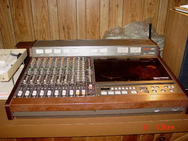

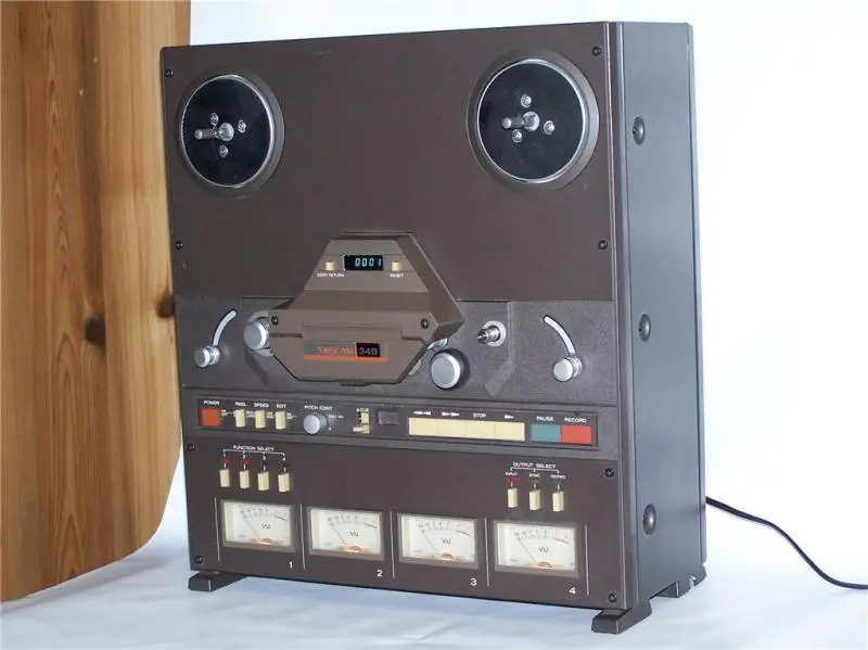

Mmmmmmm...
Tascam 34
Freq: 40Hz~22kHz +/-3db @ 0VU (15 ips);
S/N: 68 dB (NAB)/A Weighted @ 15 ips ;
.......92 dB with dbx (NAB)/ A-Wieghted @ 15 ips; (dbx: accessory)
Headroom: Recording Amp - Better than 25dB over 0VU at 1kHz.
THD: 0.8% at 1kHz @ 0VU/250 nWb/m
Tascam 388
Freq: 30Hz~16kHz +/-3db @ 0VU (7.5 ips);
S/N: 92 dB with dbx (NAB)/ A-Wieghted @ 7.5 ips; (dbx: built-in)
.......59 dB without dbx (NAB)/A Weighted;
THD: 0.5% at 1kHz @ 0VU/250 nWb/m (dbx)
That's all I've gotten, for now.:eek:;)
Specs do tell a story. Those specs look warm and fuzzy to me!:eek:;)
