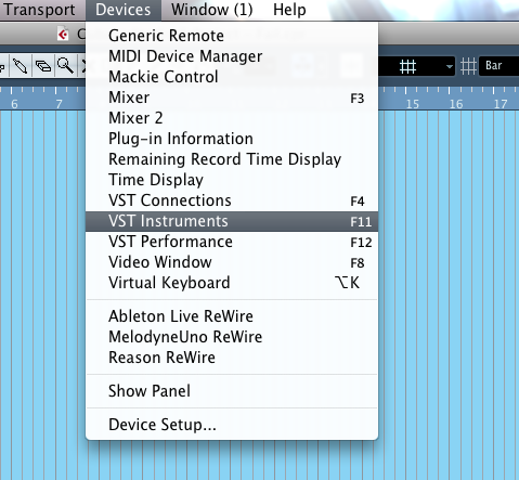

Start with a blank session in cubase then:

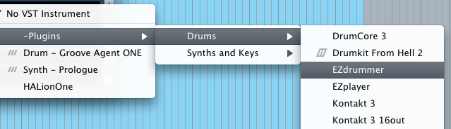

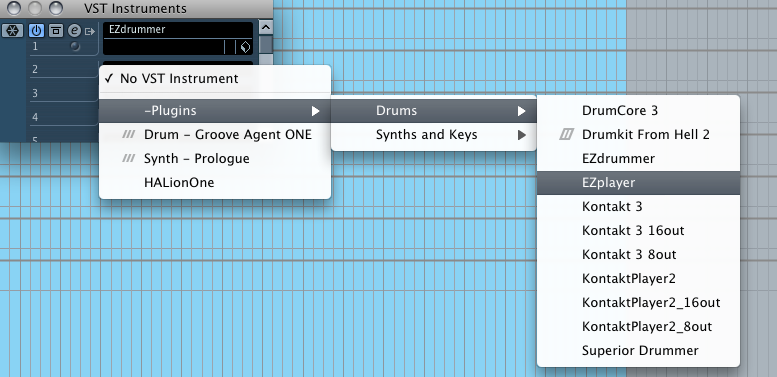

Load up ez drummer in one of the slots:

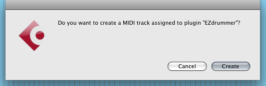

Click ok if you want, I don't usually bother but you can hit yes here or cancel and add it manually:

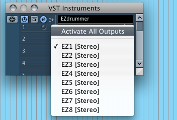

Ok so next to the "e" button hit that little thing with the arrow pointing to the right:

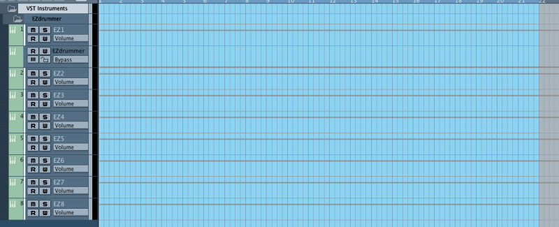

This menu pops up, go ahead and activate ALL outputs:

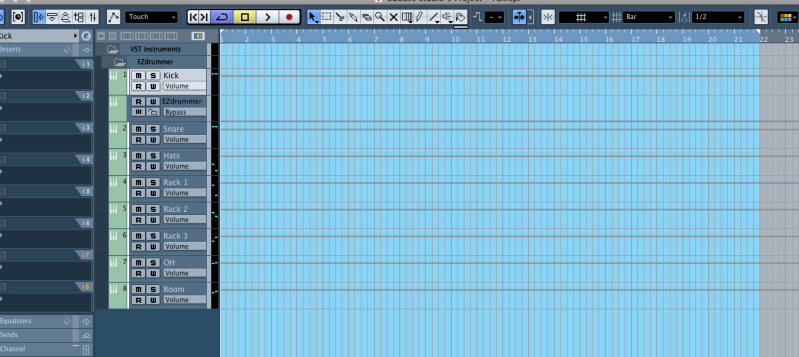

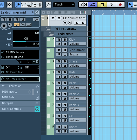

You should now have a screen that looks like so:
