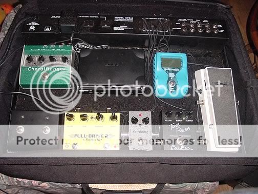

First off I TOTALLY agree with the idea of purchasing the best (to your ears) TUBE amp you can afford. It really makes a difference both in the way the amp sounds and the way it feels/plays. Definitely get your distortion from the amp (tubes) and use pedals to spice up the sound. Keep in mind the difference between power amp/non-master volume amps, and preamp distortion/master volume types. I personally don't care for rack gear at this point in time...used to go through a rack full of harmonizers, delays, etc. (Although the G-Major is a very good sounding unit as Scott said) The other alternative is to build a pedal board with the pedals you need. This way you can choose each one individually, instead of having to use what a particular company decides to place in its multi-effector. I'm playing a 2 channel tube amp for clean and hi-gain and using a pedal for my crunch(3rd channel). Here's a pic of my gigging pedal board:
Good luck on the quest!
Wow.... that looks complicated. I'm definatley gunna need some schooling on how the heck all that works together.... 'cause I don't see how it actually functions :)
I've heard of these pedal boards before, and i've seen pic's of pro's using them instead of lots of rack effects. Does the fact that the pedals are 'analog' affect the quality of the sound? In other words, would i get a better sound from an anolog device vs. using digital?
Furthermore... when using a pedal setup, like you got... Is there some sort of main controller for the pedals - Similar to the midi multi bank pedel that everyone else is talking about?
All of a sudden, I feel like i'm getting in way over my head. :(

Don't feel that way, it's actually much easier and glitch free than a rack system. My guitar plugs into the white Fulltone Clyde wah>Strobostomp tuner>Barber Tone Press compressor>Fulltone Fat Boost (clean boost)>Fulltone Fulldrive 2(Crunch channel)>Fulltone Choralflange>amp. The black box in the lower row is a channel switcher for my amp and the larger black box is the receiver for my rarely used wireless. Admittedly, the pedals I'm using are not cheap, but I find the ease of setup, and error free use is a definite plus when gigging. I also have a practice pedalboard for home use:
If you want to talk about it, email me and I'll be glad to give you a call.
Don't forget though that some people swear by their all in one boxes/rack gear...this is all just my opinion based on what I need in a set-up.
