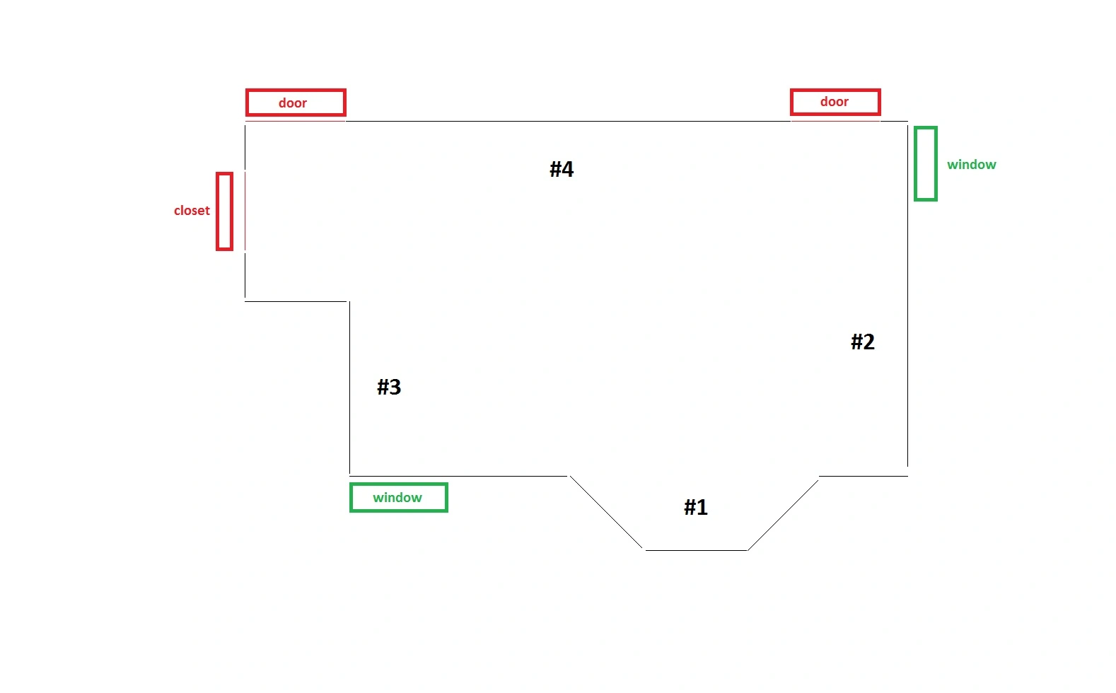

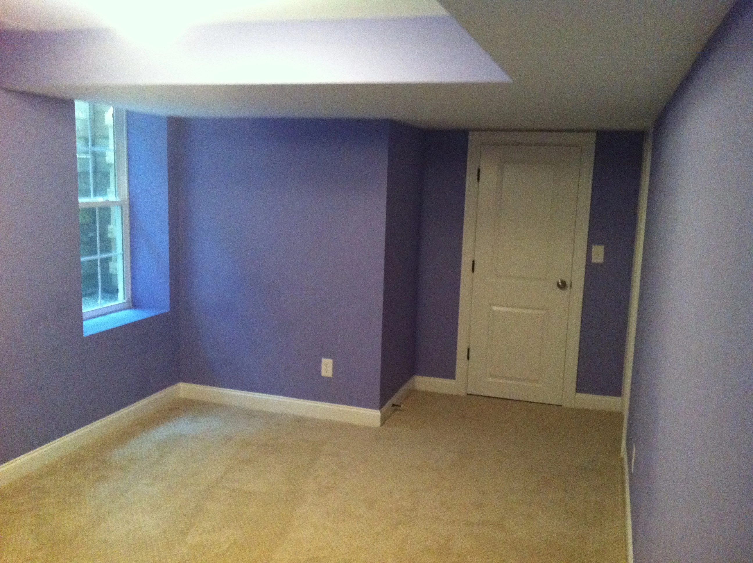

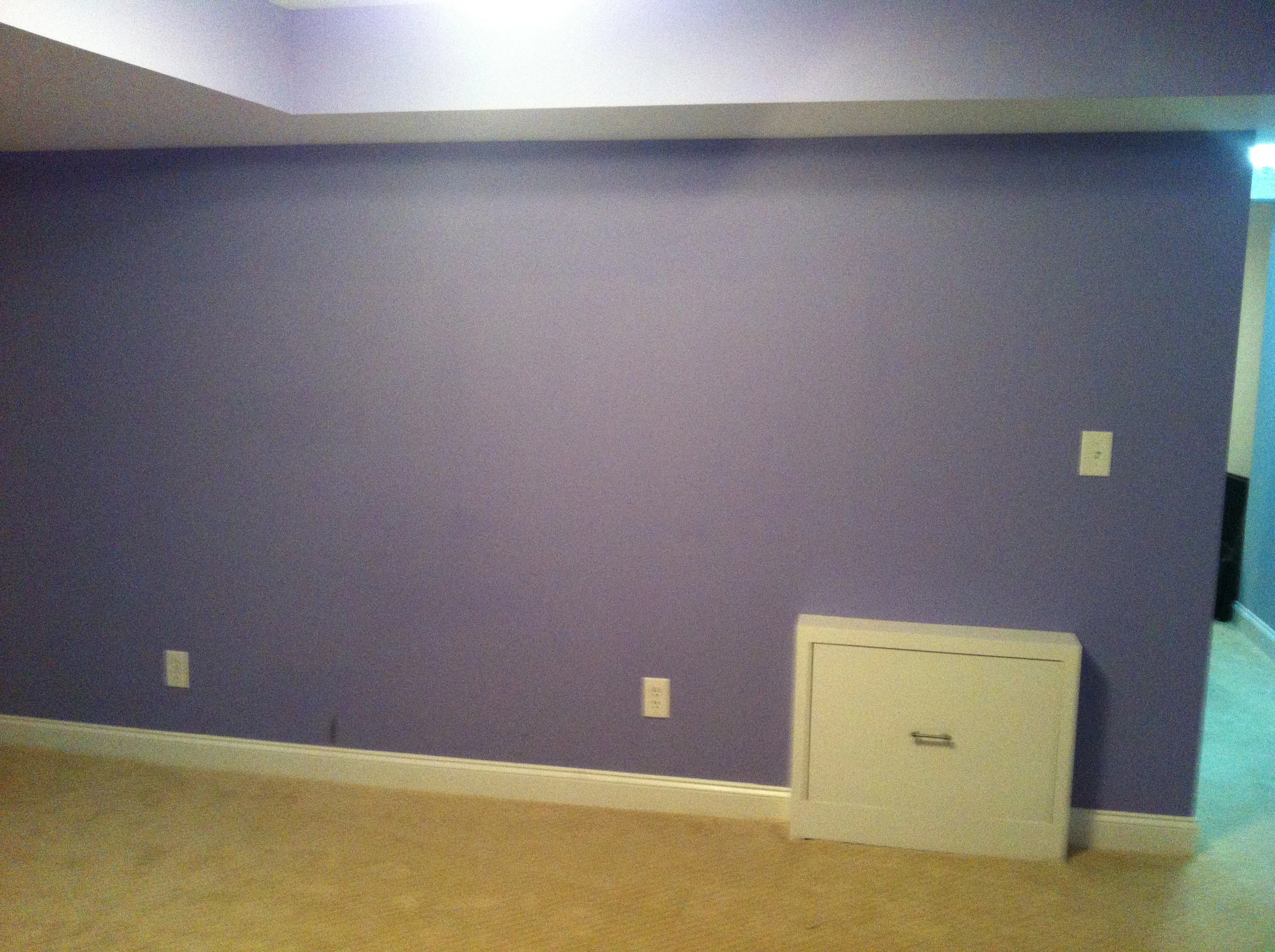

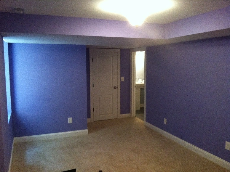

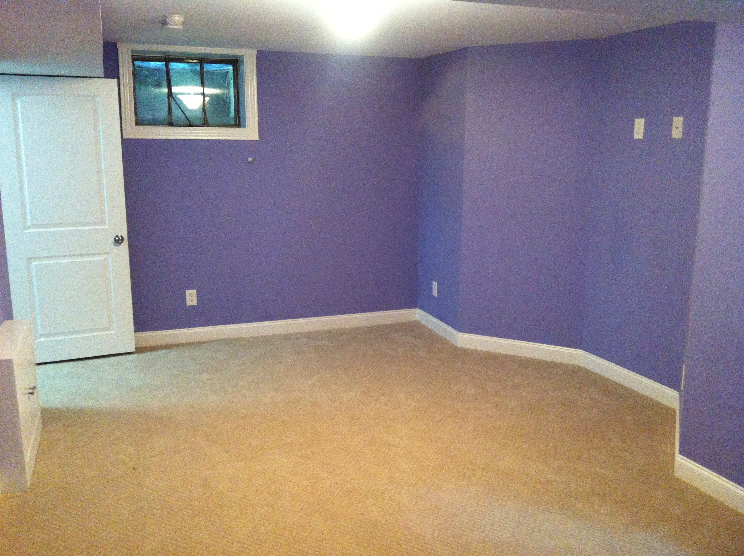

I have attached a roughly scaled blueprint of the room, and photos of it bare. Here are my concerns as of now:
1. Where in the room will the microphone be optimal for recording? My first guess (#1 on the blueprint) was solely due to the small indent in the wall. How does this change for different instruments/vocals/different styles?
2. After the microphone is set up, where are the best areas to set up acoustic treatment? I have a fair amount of foam and am more than willing to buy some more if need be.
3. Are bass traps a good investment due to the low frequencies strumming chords on an acoustic can create?
4. Will the different ceiling heights as shown in the third image affect the sound in an adverse way? Is there a way I could limit this with tiles/treatment?
And, I guess, any other blaring mistakes / things I should avoid that you see. I know this is a lot, and I thank you for your time / advice.

Those ceilings look kind of un-tall. That and the overall modest size may be compromising factors. You may need oodles of treatment to get it to sound okay.

Is that a skylight in the ceiling?
Just asking, wasn't sure about what that was...... can u give pics of the ceiling as it looks like an interesting design to work with.
I said the vocal area looks fine, but I would care more about positioning my mx desk for monitoring and place the vocal second.
Dimensions would dictate potentially where to put your mix area.

The room is 10' wide, 23' long (20' long in the smaller section), and 6.6' tall (7.5' tall in the larger bit). Hopefully this angle clears up any confusion with the ceiling, the light is removable if it is going to be a problem.

Set up you rmix desk on wall #2, in the center. Throw out the foam, or use it to make comfie seating. Build bass traps, as already mentioned for all the corners, and you'll need a ceiling cloud, too. Those corners where the ceiling changes are probematic too, more cloud/traps needed. Facing into a well-trapped corner when using a mic works because any direct reflections from the voice/instrument are absorbed, you could use the same principle in that alcove.
