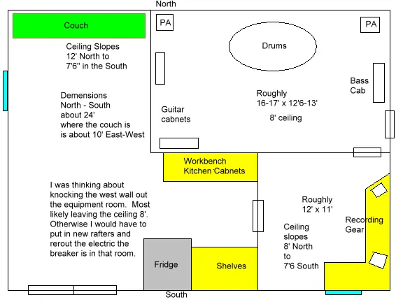

Hey D. The ceiling is 8'. The drummers back almost touches one of the 16' walls. Like I said the room is about 12'6' x 16. The drum throne is in the middle of that wall. I've been jammin on the other side of the building over the last week. It's got over twice the square footage and it sounds alot better. Way less ear fatigue. It's around 450 sq. ft. shaped like an L compared to 200 sq. ft. in a rectangle. The ceiling is at an angle in the bigger room too. Goes from 12' to 7'6". I need to post a diagram to show everybody what I have to work with, with some pics. I've gotten good results when I track the instruments individually (Demo quality in the smaller room), but crap when I try to do live stuff. Honestly, I think the room is too small to be dual purpose (recording/rehersal) considering I mostly do heavy rock shit. The bass is real bad I don't think there's enough room for the waves to form. The guy standing next to it can't hear it while that's all the rest of the band hears. Too much noise too little space. Been playing with the thought of knocking the wall out between the two rooms and matching the ceiling up. Look for my post over the next few weeks I'll try to get some visuals up. I'd like to get a few opinions before break out the sweat and the cash. If some of you vets could check it out that would be great. Don't want anymore mistakes. On a budget. I'm married need I say more. Later Pavel.
Alright Hear is a rough diagram of the building. The measurements aren't perfect but they're close. I built the place over 3 years ago. I used doublewall constuction on some of the outside walls to it throws the measurements off a bit. Also there's alot more junk than shown. Mostly shelving and gear.

Hoss, is there any place in the room you can stand, sit, lay down, etc, where the drums sound good (no screen door snare)?
What height are your overheads, and are they and the kick mic the only mics open in the room?
What mics are you using for overheads? What's their position, relative to the kit and to each other? How far apart are the capsule faces? Need dimensions from the face of each capsule to the other, to ceiling, to floor, to each wall -
Are your wall treatments opposite each other, or staggered?
Can you clap your hands and hear any "rain barrel" effect in the room? (If not, this still doesn't mean you don't have flutter echo, just not as much)
Please take all the Q's one at a time, and answer as fully as you have info... Steve
