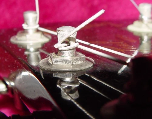

This is one of these things that is better explained with a picture than with words. Here are the words:
For the sake of simplicity, let's assume a Stratocaster tuning peg arrangement. Angle the hole in the tuning peg so that it if you drew a line through it, the line would point to 2:00 and 8:00. Insert the string through the hole in the tuning peg, from the right side, with the excess string on the left. Leave enough string slack on the right side so that you'll get about 1-1/2 wraps on the peg.
Keeping a firm grip on the string on the right side of the peg, take the excess string on the left and pull it tightly around the peg clockwise, underneath the string going into the peg hole, and then pull the excess tightly over the string going into the peg hole. Make sure that this makes an acute angle. This is the "locking" technique.
If there is enough slack, manually loop the slack on the right side over the peg clockwise and underneath the locked portion. At this point you should be able to tighten the string with the tuning peg while keeping the slack out with the other hand.
This "reads" a lot more difficult than it really is. You may need to practice with a couple of strings before you get the technique down, but it is very easy.
Here's a picture. This is the "A" string on my Les Paul. You can see that there is hardly any string wrap on the peg. Excess string is clipped off.
For the sake of simplicity, let's assume a Stratocaster tuning peg arrangement. Angle the hole in the tuning peg so that it if you drew a line through it, the line would point to 2:00 and 8:00. Insert the string through the hole in the tuning peg, from the right side, with the excess string on the left. Leave enough string slack on the right side so that you'll get about 1-1/2 wraps on the peg...
FWIW, I keep a lot of wraps on the pegs, and after the initial stretch, my guitars stay in tune just fine. Several wraps prevents slippage, and according to an article I read in Guitar Player a few years ago, wrapping to the bottom of the peg helps with sustain. I tried the so called "locking" method once, but the strings were a real PITA to get off the pegs at changing time, so I ditched it. I don't think it helps anything, but YMMV.
Yeah, what I do when I change strings is to cut them between the nut and the tuners - otherwise they are a PITA to get off.
