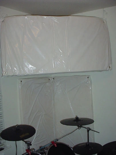

What you want to do with the rigid fiberglass is place it so it spans the corners of the room. The fiberglass panels should be touching both the walls, so there's a triangular air space behind them. Even though I can't space this correctly, you get the idea. |_\
No, like this. The one on the top. Mine are covered in plastic, but fabric would be better. Actually, I believe it would be better to turn them on end and have them cover more corner. See what I mean now?

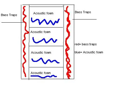

Ok I did some more reading, and I think I'm starting to understand more. I should have bass traps in the coner of my booth, Difussers on the ceiling and acoustic foam in the middle of the walls.

I'm not the expert here but...
You might as well use rigid fiberglass (4lb dens) instead of foam TP. Just make sure you have a couple inches of space behind them. I'm curious MR as to why you didn't just layer those two panels closest to the floor together and sit them in the corner? You might get better trapping with airspace behind the panel.
This guy's right, rigid fiberglass is the best bang for the buck by far for acoustic absorption. Just get some 2" fiberglass, wrap it in fabric, and hang it on the walls, it'll perform better than foam.
It's hard to see by the picture, but my electronic drum set uses a 14" snare in a stand that I built for the bass drum. The trick is that it'll walk across the floor as I play, so I face the set into the corner which also maximizes the space in the room. But the stand is in the corner with some books buttressing it, so I can't put anything on the floor right there. I have bass traps in three of the ceiling corners and two of the floor corners, which is all I can fit in the room.
