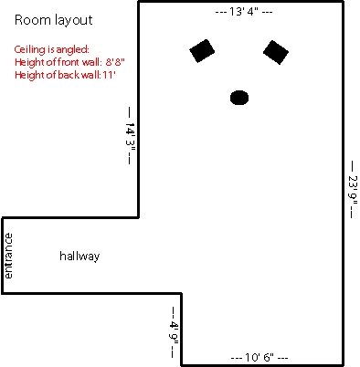

Sorry about that... here are the dimensions. Like i said i do a lot of urban music so the lower frequencies can be a problem sometimes, which is why i was thinking "more" 4" panels than just in the corners.
