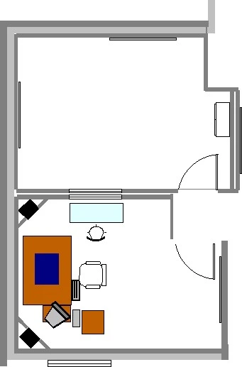

I guess you could consider what I have a small room. It's about 11' x16' ... and this London-16 is designed for a 12' x 16' space. The studio room is about the same dimension as the control room.
Except for a knockout in the room for the door ... i'll post a pic of the floorplan and layout I'm thinking of.
btw, the monitors aren't soffit mounted ... yet. It only looks that way on this pic because I was trying to see if I could get away with it in this small space.
thanks again for your responses
Dave
