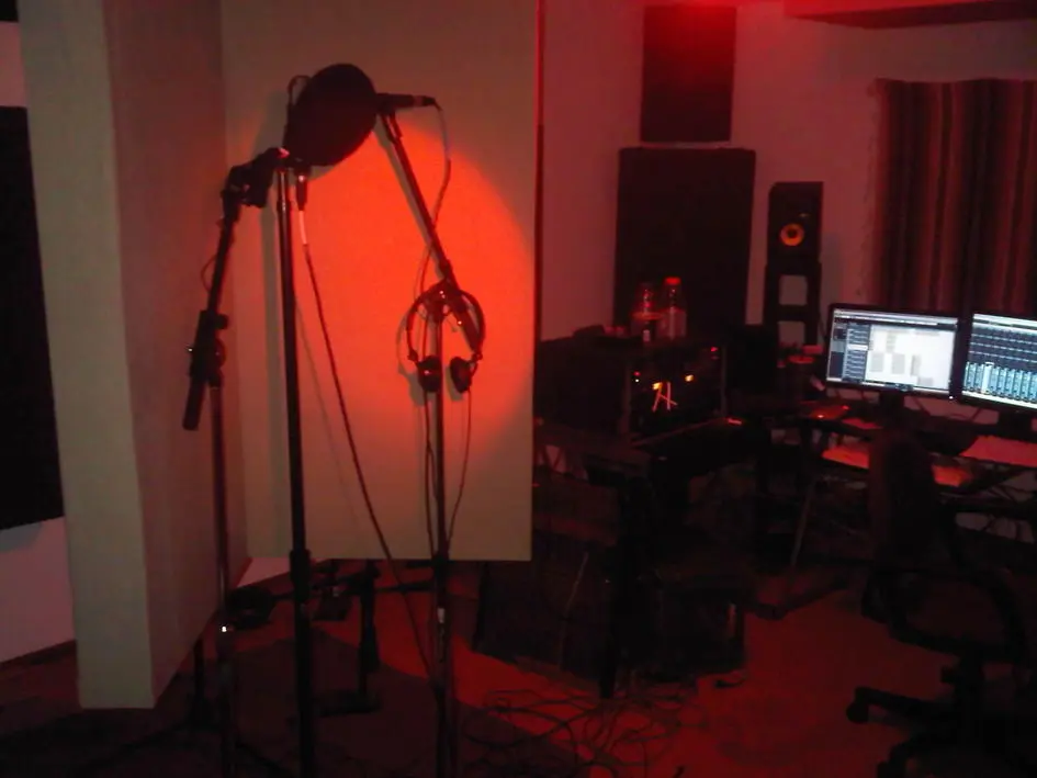

I myself hang two portable 2'X4' panels from the ceiling, forming a 'V' around the back of mic when tracking vocals.
