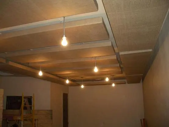

Here is a picture of the burlap covered panels. The ceiling is not quite finished and I have 40 more panels to build before I am done, but you can see how they look.

I like that burlap look. could you possibly post a close up of one single absorber? The room is going to be a red wine color so that tan burlap would actually look pretty good. thanks.
