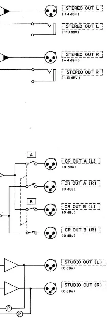

I figured I'd better not keep advising by memory and brought my manual home. It's for the automated version of the console, but you may find these scans helpful...it's a two-page foldout, so sorry it's in two files-
http://www.sendspace.com/file/98gkc8
No reason for apologies Briank, thank you very much! 90% of what I'm looking for can be found on the schematic.
witzendoz: Once the board is all setup and installed, my monitors will be wired up to the CR outs but right now, in the testing phase, no connector shall go unconnected! With the level issue I've been seeing on the CR and Studio outs I was curious to test those outputs volumes.
Looking at the schematic briank posted the 'Stereo Outs' are +4 on the XLR and -10 on the RCA, as expected. The Studio and CR outs are all labeled '0 dbu' and the illustration for the XLR connector seems to indicate some pins are wired together, suggesting they are unbalanced on a balanced connector. The schem also indicates the audio is unbalanced. (A triangle indicates an amplifier on the schem. If the right tip of said triangle is black, it's a balancing amp. The CR and Studio signal paths do not run through a balancing circuit.)
I thought I had my mind wrapped around +4dbm and -10dbv but now 0 DBu! If I could find a handy calculator to give me a direct comparison between the three output types I'd feel a lot more confident at this point. I've been digging around on the interwebs and I have seen people using dbm and dbu interchangeably and people offering ways to convert the two. I just want to be sure my outputs are working properly...
If the line level shifter is working for you briank, then it should work for me too. It just leaves me wondering why timkroeger's M-3500 doesn't need one but my M-3500 and your (very similiar) M-3700 do. I was going to pickup a couple of the 8 channel shifters just to have around to match levels between various bits of kit but to manage costs at the moment I'll buy the smaller one just for the monitors.

Kinda adds an extra dimension of confusion, doesn't it? I'd forgotten about all that, and thinking about it, I seem to recall I played around with and without the level shifter and found it was quieter and the levels more agreeable with it...looking at that diagram again makes me want to play around again :D
One thing to consider about Tim's mixer is that it's probably a Euro-spec version. Those did have some differences though not sure it output levels are one of them...
