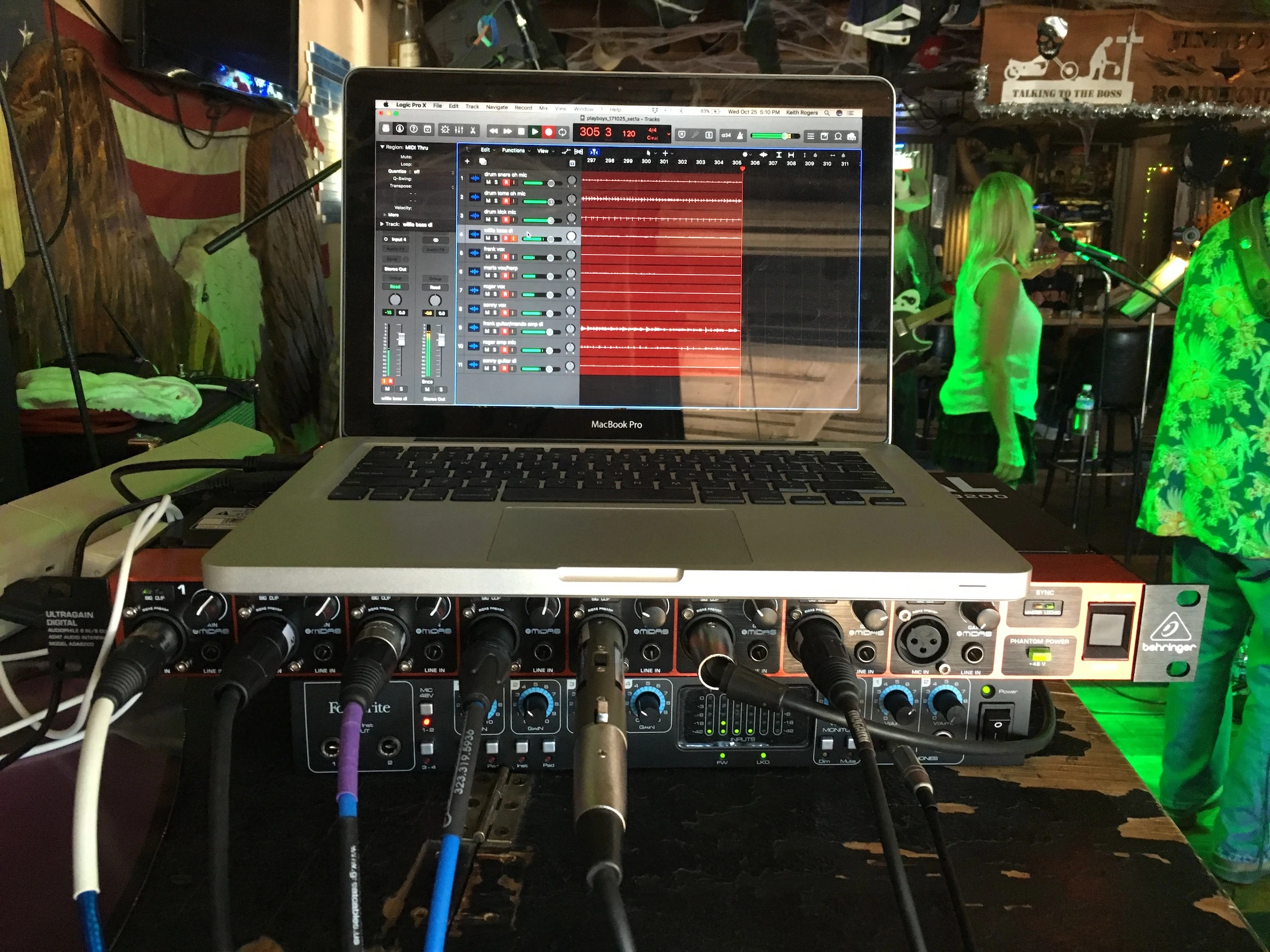

[MENTION=2337]Keith[/MENTION]: didn't get what the image is aboout :-0

... Keith didn't get what the image is aboout :-0

It was just a picture of my 2010 MacBook Pro doing live recording a few weeks back. That's not nearly as taxing as running a bunch of VSTs and software instruments though, so don't know if it would pull its weight in that usage anymore, though it has an SSD and 8GB (came with 4GB back when).
