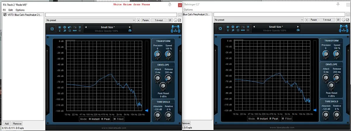

The mics showed up today, so I decided to give them a good workout against my M5s. First thing was to set one up on the bar next to an M5. I used a white noise file on my phone to set the level to within about 0.5dB. I recorded the white noise and took a profile of it with the BlueCat plugin,. Both were hitting between -55 and -60dB ( the phone wasn't loud). The preamp setting on the Rode was straight up, the Behringer was just a tick higher, maybe 12:30 on a dial. Not a huge difference.

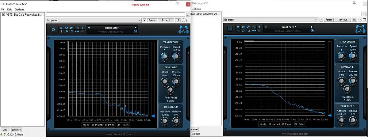

Then I just looked at the mics with room noise, trying to be really quiet to see how their self noise levels would compare.The Rode M5 was 8 to 10dB quieter here. This somewhat surprised me since both claim 19dB self noise and 75dB S/N.

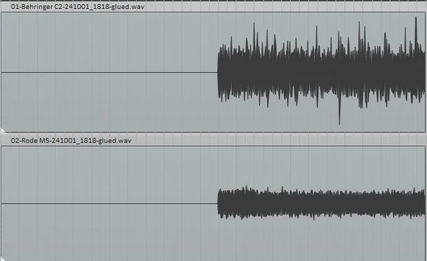

I boosted a section of the quiet room comparison for both mics by the same amount. There's a distinct difference in the noise levels. The approximate 10dB difference was confirmed with the channel meters.

So, is the C2 a piece of junk that I can toss in the Goodwill pile? Nope. Yes, it's a bit noisy, and kind of bright, but the brightness can be tamed with a bit of EQ, which should also help with the noise. But I didn't get up really close (singing about a foot away, playing about 18 inches away). It supposedly can handle 140dB so getting close for more volume might lower the noise floor plenty. Or you could just say it sounds like tape hiss.

looks like the C2 has a lot more going on 220hz and below. M5 has a bit more activity in the higher FREQS.
charts are showing a difference in the mics freq response.
what's the sensitivity of each?
The M5 is rated at -34 dB re 1V/Pa. Behringer C2 is listed at −41 dBV (0 dBV = 1 V/Pa).
Yes, the C2 shows a higher level of low frequency noise, but in use, it is distinctly brighter, which doesn't necessarily have to be the same as the noise profile of the mic's amp circuit. Also, the "quiet" plots were made in the room that isn't an anechoic chamber, just a quiet basement late at night. It's more "real world" usage for me.
I could have put them inside a heavy padded box, but I didn't want to disturb the setup of the mics. Maybe I'll do that later when I finish doing my recording. I've left all the settings on the interface the same, so the comparison should be good.
