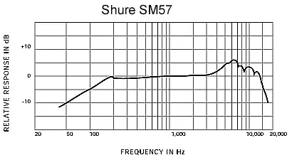

bennychico11 said:
and what's the frequency range of the SM57 microphone?
Flat out to about 40K or so.....haha yeah right. I think it drops at around 18K (or maybe it was 16K?).
Ms. Hilarious said:
Anything north of 48 is as good as it gets, 64, 88.1, 96. Above those rates there is the possibility that a reduction in precision could occur.
Yeah dude, preach on. Once you get past the effects of the anti-aliasing filter (plenty of space to filter when at 96K), then the only areas to really improve a PCM digital convertor are with the clocking, the analog circuit, and other mechanical type bits. Although I suspect that at some point the notion of reduction in precision at the higher sample rates will become irrelevant as the smart dudes find ways to throw electrons around faster and faster. I guess audio recording marketing weasels gotta feed their families too! <sarcasm>I can't wait to hear the first album recorded at 384K; it is gonna be sweet! I think Korn had one of the first albums done entirely at 192K. Yeah, it was at least twice as good-sounding as their one before that. </sarcasm>
by the time it reaches 20kHz it's already -10dB down.
one of the most popular mics, combined with the filter slope....is there any positive with recording at a higher sample rate? Do we only reserve the highest sample rates with the flatest condenser mics?
Actually according to that chart it's even more severe than that; that response line never even reaches 20k, and is already 10dB down by the time it ends at around 16-17k.
If EVERYTHING is recorded with a 57, then no I would have a hard time seeing any benefit recording at a higher sample rate. There is a little benefit to recording at higher sample rates if you record some of your tracks with mics that don't roll off the high end so much. Of course you don't want to set a new sample rate for each track you record depending on the mic being used, so pick one and stick with it. And as I have said elsewhere, until people start buying 96K CDs and 96K mp3s, I don't think there is a great big reason to worry too much about sample rates above 44.1K.
