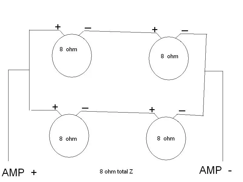

Basic wiring for a 4x cab with 8 ohm impedance using four 8 ohm drivers.....
Is that parallel or series?
I'll venture a guess~parallel?
:D its Both :D
Two pairs in series, then the pairs in parallel
