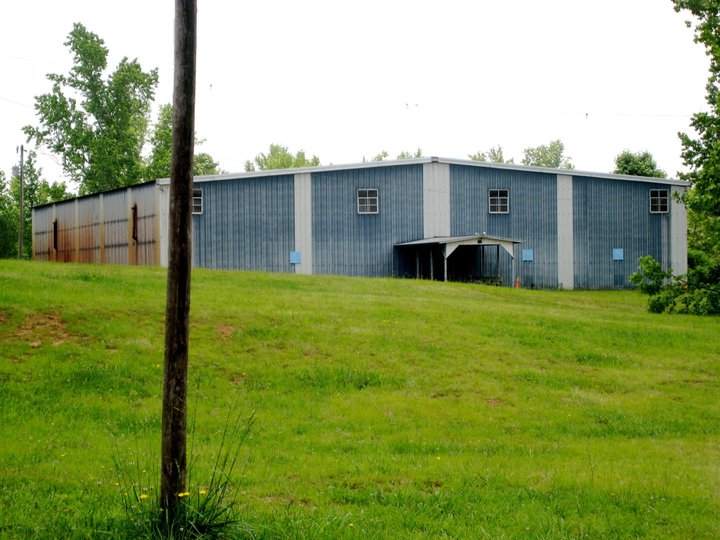

the song was tracked in this space :

No reverb was used in the making of this feature (with thee exception of a little amp echo on the overly distorted combo that re-amped Jeanie's vox), the rest is natural from instrument/room mics
