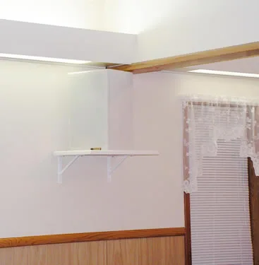

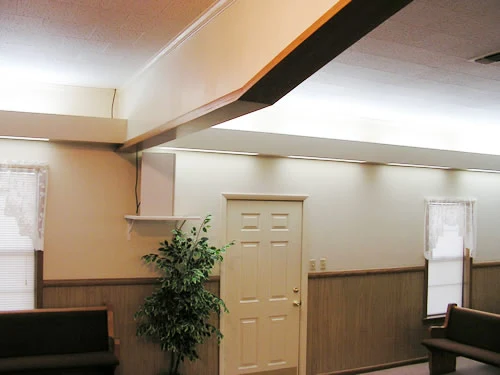

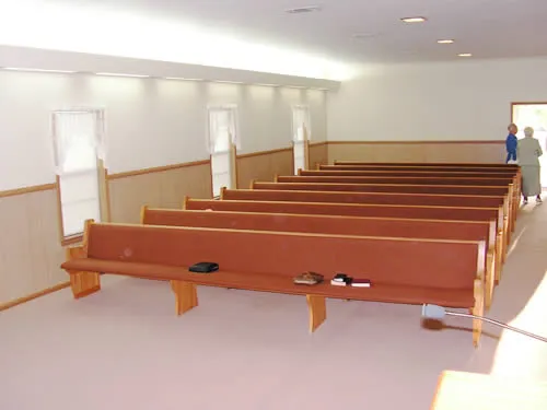

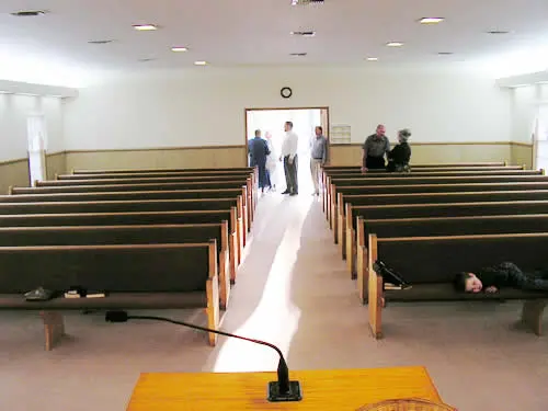

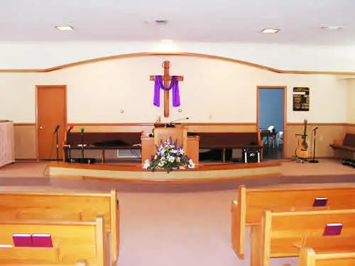

Here is the divider thing, and a side view of one of the speakers from the stage. :)
It took me a while to get my pics into Fireworks and fiddle with them. :p
speaker on the left side of the house.
Front and center. You can't see the speakers on either side, but they're there. LOL
View from the pulpit.
Left side from pulpit. :D This is the last one.
The reason some of these pics look so different is because I played with the color curves and stuff in Fireworks so you could see them better. The benches are different colors in each pic. LOL :p

Looking at those pics should show you in any case those speakers are totally inappropriate for the venue.

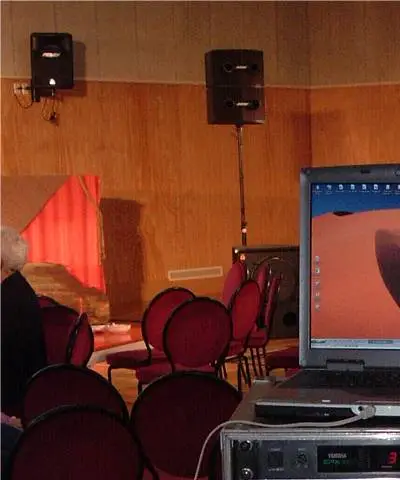

A little harsh
Hi - I think you're being a little harsh on Bose. I've used 802's a number of times for Church services and the like, and they work nicely in some environments where other systems crap out.
I agree they're not the be-all and end-all of sound; they're not good for very large gigs, but for a couple of hundred people at a service in the local school hall (a very echoey environment) and teamed with some JBL subs they performed admirably. Sounded significantly better than the amplified Peavy's that were installed there already! (you can just see one side in the attached photo)
I've heard the columns, and they're effective for speech. I suggested them in this thread because of the environment - whether they're worth the extra dollars or not is another story, and there may be better options out there. It would be worth auditioning them along with the Mackie's I suggested and the suggestions that you and others made here. You can't take anyone's word about speakers until you hear them in your environment.

See, based on my experience, quality of the product aside, there is no place in that room to effectively use those boxes. It's just the wrong place for a line product, due to it's size and characteristics. After designing and installing many systems, I feel pretty confident in saying that. A line box doesn't belong there.
Those things like the 3db vs. 6 db loss, and the vertical control, those benefits of line technology, they depend on the length of the array. It's just the physics of the thing. The shorter the array, the higher the frequency at which they can occur. Bose recommends two stacked vertically to achieve those characteristics down to 200hz. With one, the speaker acts as a coherent line source only down to 2K. Below 2K, it is just like any other speaker in terms of pattern control and SPL dropoff. All the line benefits are gone. This also means at 25 feet, everything below 2K is about -10db from everything above 2K, and it gets worse the farther you go. Not pleasant to hear at all.
Two stacked means a 7.5 foot stack of speakers. To achieve control across the full range of the box, more than two high are needed.
That aside, even if one box had full control across it's range, it still is the wrong choice. There is no place to put it to use it's pattern effectively without big problems.
