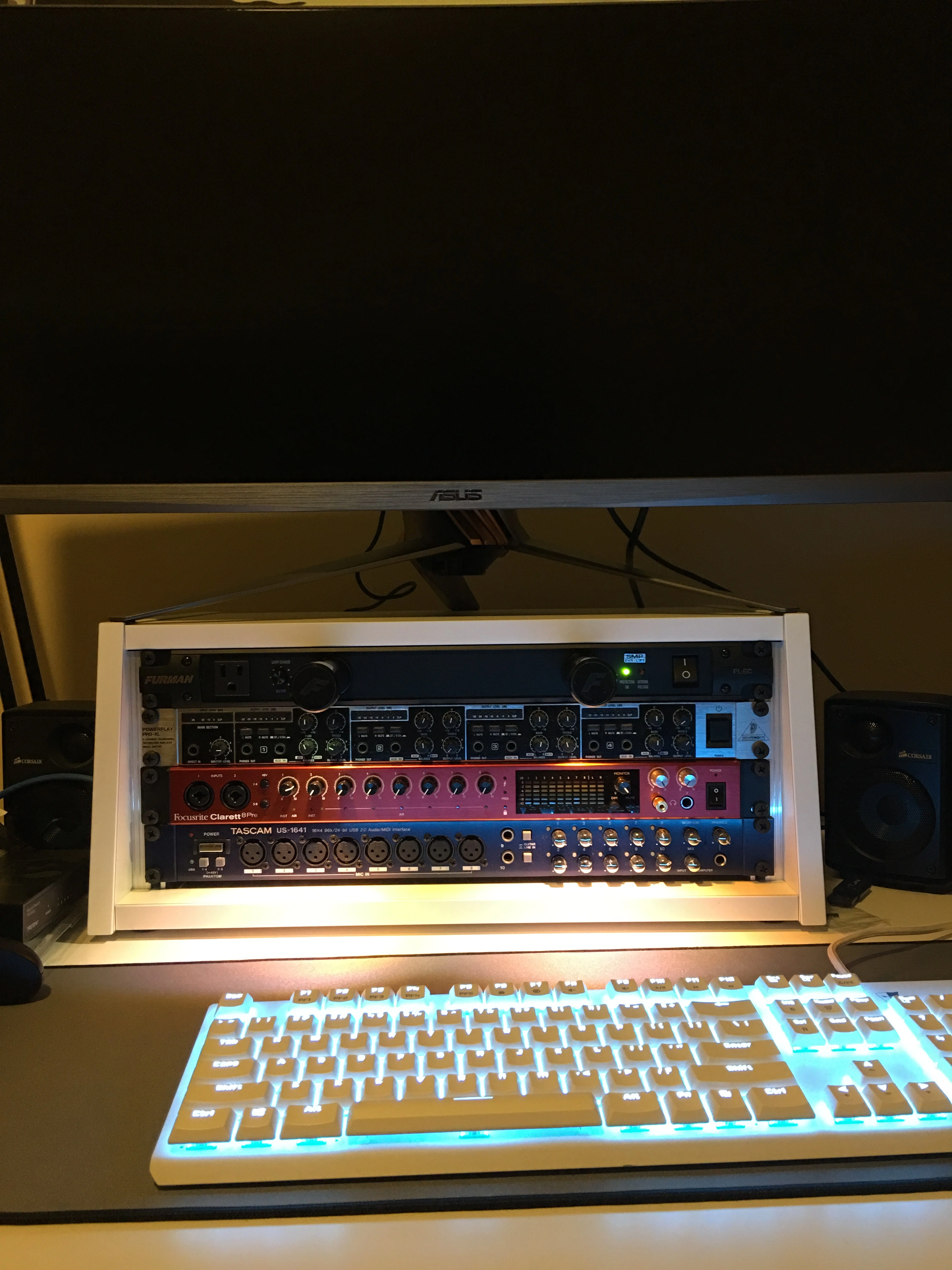

So here is my setup. I didn't want to lose the headphone amp space to a preamp but I guess I'm all set. The Tascam is just a place holder and is not connected. Thanks for everyone's input. Now is there another unit I could add that would improve the the overall recording? At this point it's mainly an aesthetic reason. Here's what my setup looks like. IMG_3278.webp
Hey. That looks nice!
Long shot, but if the tascam has adat output and the clarett has adat input (which I think it does), you could rig them up for a 16 mic-preamp setup. :)
