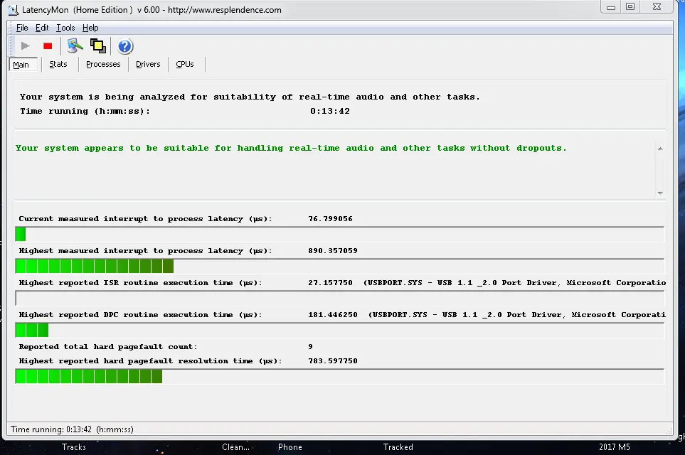

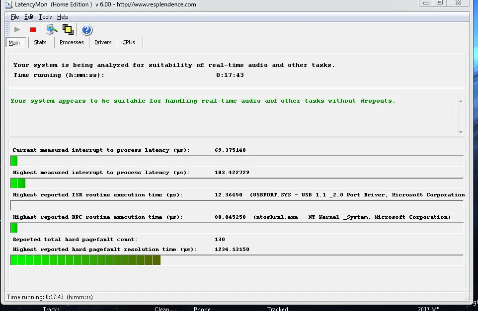

Ok, so I didn't have any 'page faults' until I opened the 'snipping tool'. Neither with Cubase running or not. The Highest measured interrupt was also peaked at this point when opening the snipping tool. That would be Windows taking over it seems. It is inconsistent as It never goes over 5 bars without opening the snipping tool. Cubase open/playing or not.
My system is built for running audio and 3 video monitors. Nothing else. Well, internet is connected but browser not opened. I only use it for occasional file transfer/export or software downloads/updates. Never for Windows updates. Here are the results:

Mack, I'll just add/emphasize one thing: The "latency", aka the time it takes to resolve hard page faults is absolutely the most minor problem there. You shouldn't be getting those faults in the first place, or at least they should be rare (like in Jimmy's case). Experiencing them means either that you don't have enough RAM for what you're doing, or there's something wrong with your virtual memory settings.
