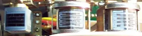

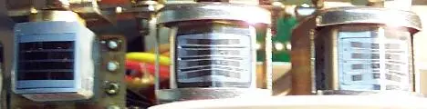

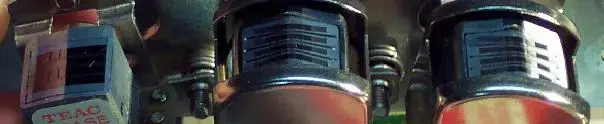

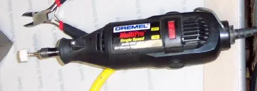

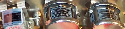

Here are some photos of the heads buffed up and the tool used. I still need to do a full recalibration but as it stands it now is -3 db at 20kHz. Not bad.
Long as I had it apart I replaced the 4558/4559 opamps with OPA2132. I also noticed that it would be easy to switch it over to IEC-1 eq if one wanted.
I'll post a full response curve when I get a chance to cal it up again. Work has me tied up for the next week or so. Time will be short.
--Ethan
PS I suspect that a few hours tape motion will add to the polish....

Re photos of heads, they really need to be much more magnified to be of any use for diagnosis. The working faces of tape heads need to be viewed at least with some kind of magnifying lupe. I mean when looking at them with your eye. The most important area is the part where the tape actually touches the head, ie: the small area around the gap.
I seem to have spent much of the last 20 years staring at tape head faces through magnifying lupes, both before and after relapping. Since I'm not a youngster any more I need more magnification than I used to but even so, some sort of magnification (close up lens) would be necessary even for the younger folk.
Sometimes sticky shed muck can be very hard to remove and, if left on there for a long time, can corrode the surface because it seems to hold moisture.
Sometimes the head needs relapping because of this even though it's not worn in a mechanical sense.
You're right that recording tape itself can do an excellent final job of polishing the head face to perfection.

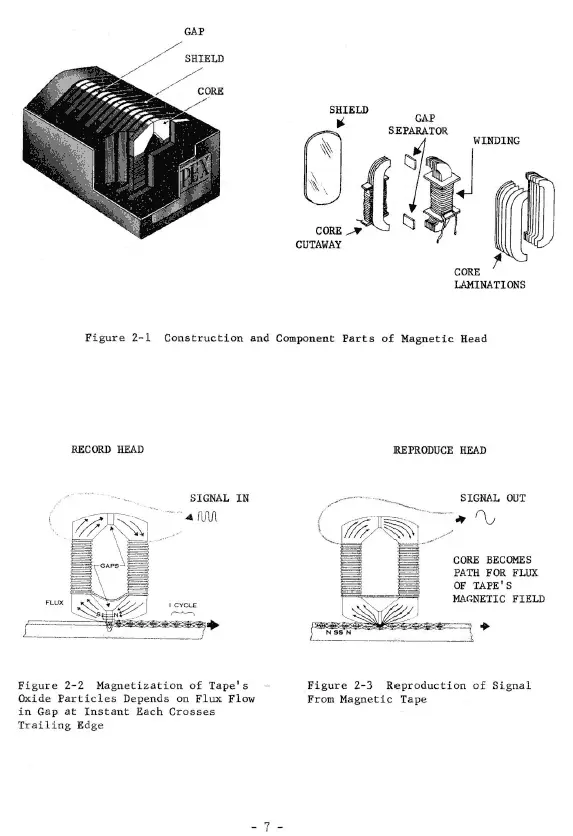

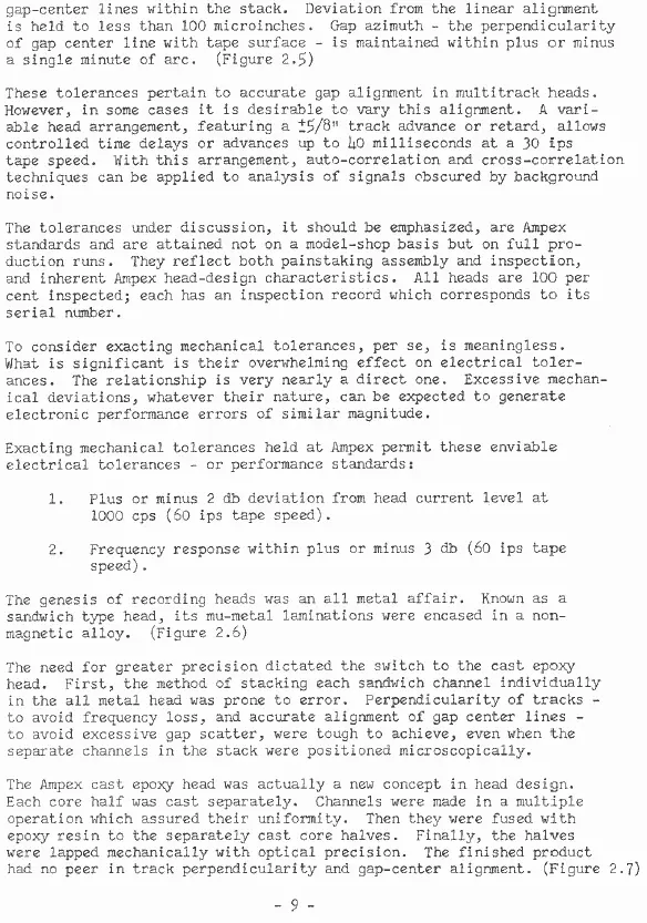

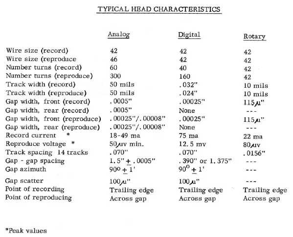

Steve, d-load THIS .pdf , there page 6/chapter II. (note: that's page 15 of the pdf file)
Well, I tried downloading it but this computer just doesn't have the wherewithall for a file that large I guess. Think I need a new computer.
EDIT: I did get to that page. Pretty interesting. I'll have to find a way to download that somehow.

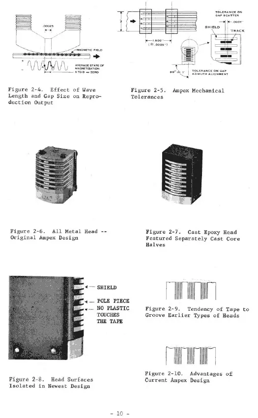

I'll try to attach .gif pages...

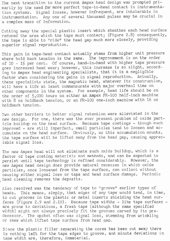

two more pages

Steve, it's kind of pain in the neck reading large pdf files if the file is not on your computer but on the server... well, it's still possible.
anyhow, ... this document contains some interesting information and illustrations as well... not all related to audio recording... but I'd say it does not hurt to have some general idea about all that stuff .. if you've got time to waste , of course :D
