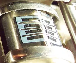

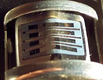

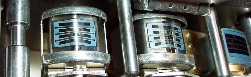

I'm not experienced in looking at heads so here is a photo if you would care to lend your experience and comments.

evm,
It could be a number of things, singly or added together.
You are right to inspect the heads physically. Hard to tell this from the picture. They look OK but.... The tape path surface should be mirror like.
The record head's vertical gap should be almost invisible at normal viewing distance. if there's a strong black vertical line showing, the head's gone, or at least the track segment which has the line is gone. Both heads should be physically aligned so there's intimate contact at all head gaps.
The record head's azimuth must be lined up to the play head's azimuth (the play head is probably not too far off if it replays a standard test tape OK).
High frequency response is sensitive to record bias level. This must be checked after the other things are checked. (In short for all of this get the service manual and follow it to the letter!) When adjusting record parameters, especially frequency response, use a lower recording level, such as -10 VU or even lower. A modern tape like 456 should be able to handle tests at 0VU. The higher then tape speed the less critical. But there's no point in pushing your luck. Be conservative. The reason is that the highs overload before the lows and mids and then they just compress down. If you keep pushing the highs even further you actually get an inversion. The more you boost the highs, the less you get off the tape. Best to check frequency response at a recording level well below 0VU.
Record heads as they wear change their inductance. That means that depending on the type of oscillator feeding it, the bias level that was appropriate when the head was new may not be the same as the bias level required when some of the metal has worn away. The tendency is for the record head to gradually become overbiased, which wipes out the highs.
If you dont know this you might conclude a head is useless simply because the highs are down. It may have just need a bias tweak.
I suppose it's possible the record eq is faulty but I'd be checking these other head and bias level issues first. They're the more likely culprits. I'm not that familiar with this model. Maybe there are other issues specifically related to the 34B that others on the thread can help you with? As in the manual, record eq is done after bias adjustment as a sort of fine tuning.
Hope this helps,
Tim

Sorry about the poor quality of the photo. I have seen a worn out head where the gap started to widen. Don't see that here.
I'm thinking about that roughness and asking myself what was done to the heads. I might try polishing them to see what will happen. (per noretronics handbook)
In any case I'll restart calibration from step one just to be sure that nothing was missed.
I think the head photos are very good. Speaking from experience of having bought an unused 34B, I can see the curvature of the heads being similar to mine. The heads, tape lifters etc ... look like they never or very rarely passed tape over them. The only thing I'm worried about is the lack of a mirror like finish, as was already suggested. Could it be some oxidation starting to show .. or a chemical being used ? I don't know but there are specs of some greenish / greyish substance there ... :confused:
if i'm not mistaken, those heads are not shiny as they are made.
as for the photo:
the areas of the heads (that looks on my screen as rather blue-ish) are not polished-like (unlike some many other heads, which are pretty solid-shiny all around). what ever it is made of - I have no clue, but that's the way it is. If you look at the heads with natural light - the color is rather grey (or silver-grey, but it's flat, not glossy). If you point some light on the heads, those areas can reflect the light and look pretty blue from some angle.
also, these heads shape (when new) is somewhat pointy and very narrow area (that is in contact with the tape) may be somewhat polished and so look (or say - be) polished and shiny (maybe somewhat 1-1.5 mm wide).
The inclosure of the head (play and record) (I am not sure if "enclosure" is what it's called :o... , ) is made of some different metal and is pretty shiny, also I don't think that the condition of the enclosure has any effect on head's performance. The erase head got no shiny metal at all - poor deprived baby :p .
I'd say, the heads look very good... from what I see.

The heads look very shiny now with a mirror like finish.
