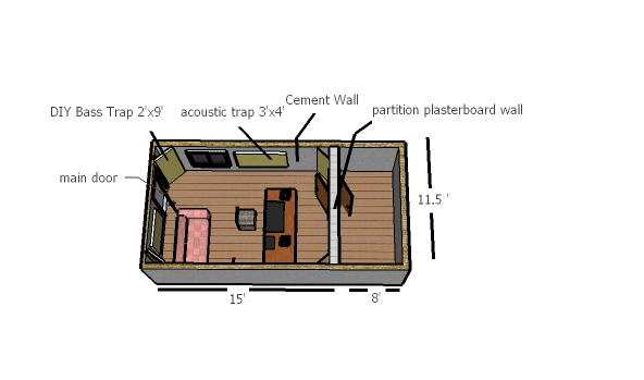

In my image, It's my plan for placing acoustic treatments in my control room.
I can't do room-in-room method cos of my budget :(.
In my image, my CR will be 11.5 x15 x9 and vocal booth will be 11.5 x8 x9.
I know my C.R acoustic treatments are not good enough in that image. My questions are,
1. What should I fill on cement wall in my C.R? Is it enough if I place DIY traps like my image ?
2. For C.R ceiling, should I place acoustic foam at everywhere?
And any suggestions for my plan ?
btw, I didn't make any acoustic in vocal/recording booth. But Im planning to place acoustic foam at every inner surface of booth.

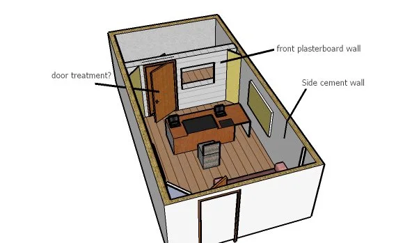

I'd also plan at least a 4'x4'x2" absorber to catch the ceiling reflections and also be over your head.
Concrete does nothing for absorbtion so you'll need more than normal. I'd plan on killing the entire front wall including the door.
For a vocal booth, don't kid yourself. Thin foam will help some but not go anywhere near deep enough for male voices. Male voices can easily extend below 200Hz.
Bryan
Thanks. I will place an 4'x4'x2" absorber over my head. Only one absorber is enough for CR ceiling? Should I kill entire ceiling?
ok, I'll kill entire front plasterboard wall with 2" foam and then fabric cover it. Is it good? Any suggestions? Do I need to kill entire rear wall and side walls too?
Thanks in advance. I'll research more about vocal booth.
btw Bryan I have also checked GIK site and I saw a pretty control room on it's homepage with black absorbers on upper parts of front and rear walls.
I would like to know what materials used at the wall surface below and under that black absorbers. In the picture, the surface is yellowish white color.
I would like to know what treatment materials should I use for front plaster wall, entire side cement wall and door. I will show it in my image.
Thanks!
