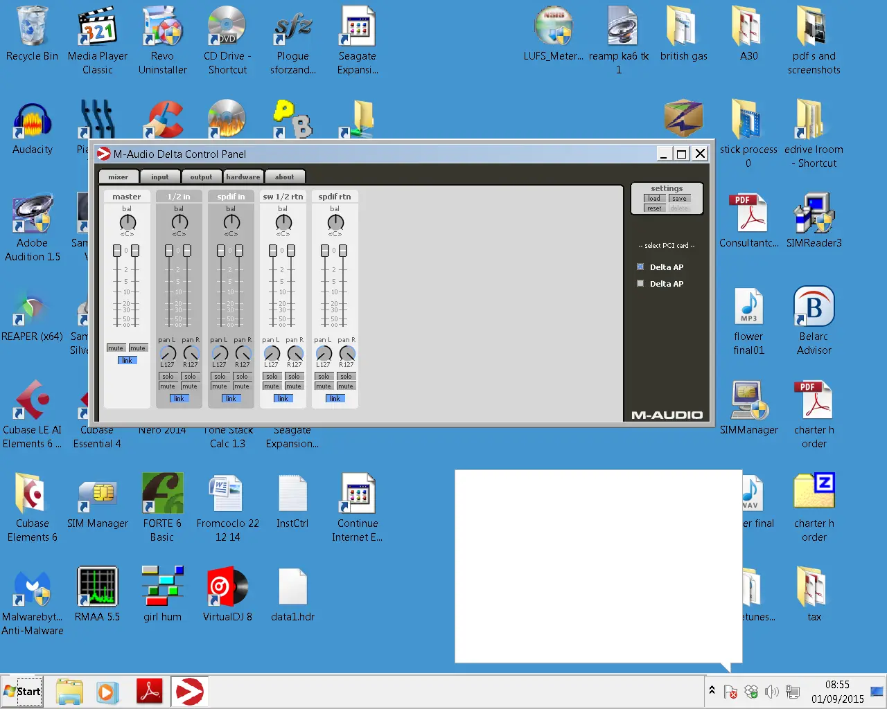

The Delta cards simply sync via S/PDIF.
You can see I hope in the control panel two tiny squares on the right? You select whichever card you want to set.

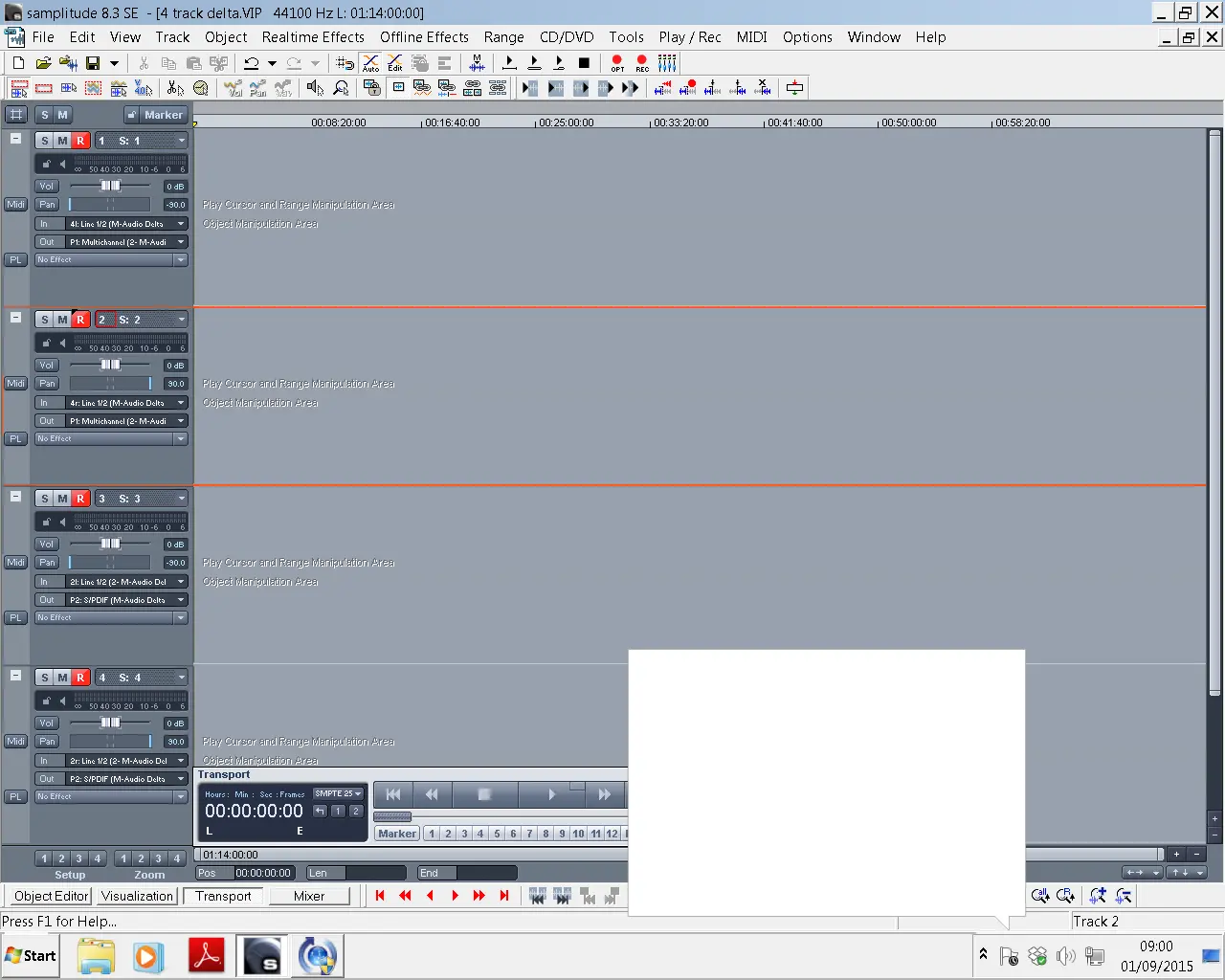

The other screen grab shows Sam 8se setup for 4 tracks so One and Two are Delta L&R (1) and 3 and 4 Delta L&R (2). Samplitude however allows you to set ANY device mixture as n input this way. Can't run ASIO drivers of course (except in this special case).
Heh! I actually built a new PC with 3 PCI slots to house the cards because Son wanted to run a Teac A3440 in and out. Built the PC, found the cards then he sugared off to France!
