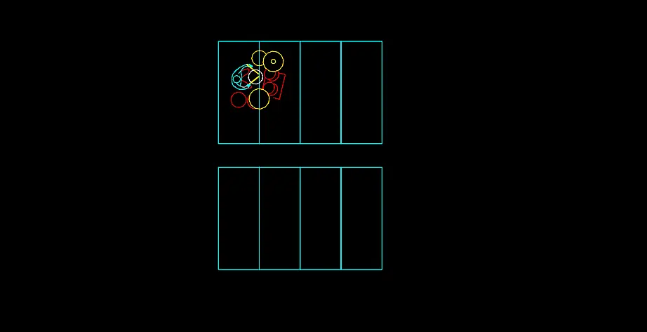

Hello crosstudio, I personally don't think it is. Here is why. Each rectangle is a 4'x10 panel. Each set of panels is equal to 10' x 16'. This is to scale. Do you think there is enough room?

hey fitZ..Is the drummer in your picture available in DXF format? Is it part of a collection of instruments that are drawn to scale? Thanks.
damn.
i never record in a group anyway, but i wanted to have the option.
maybe i'll cut the length of the live space to 6 feet and use part of the width for storage and the other part for an amp closet.

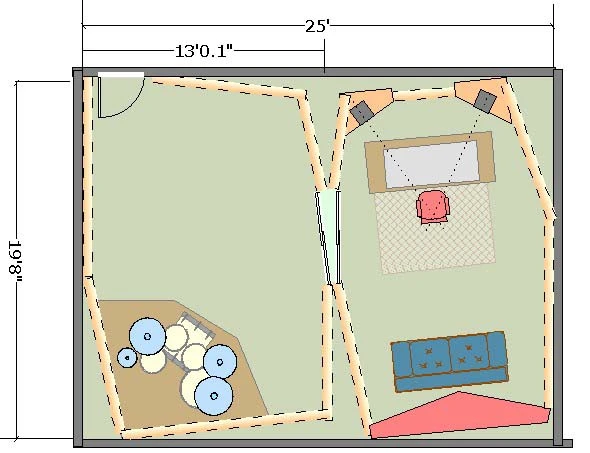

Since your in a basement you could limit your construction to somethings like fiberglass-drywall-2x4 frame<w/ insul. and still only loose like.. maybe a foot total depending on how you did it for the walls. Your main issue <from your post> is Upstairs.
Having said that I tweaked my own design to fit for you.
Could work.

It's going to be tight. I think it would work though.
How 'bout you have a mixing/tracking room, and an iso booth?
You could use the big room for doing drums and whatever else is too big for the booth. Do everything else in the booth.
All I have is a 13'X15' room. It's going to be tight for doing drums next week. It's also going to suck have amps blaring in my ears. I might just run the amp upstairs or something.
oh, that's beautiful. much better than what i had configured.
