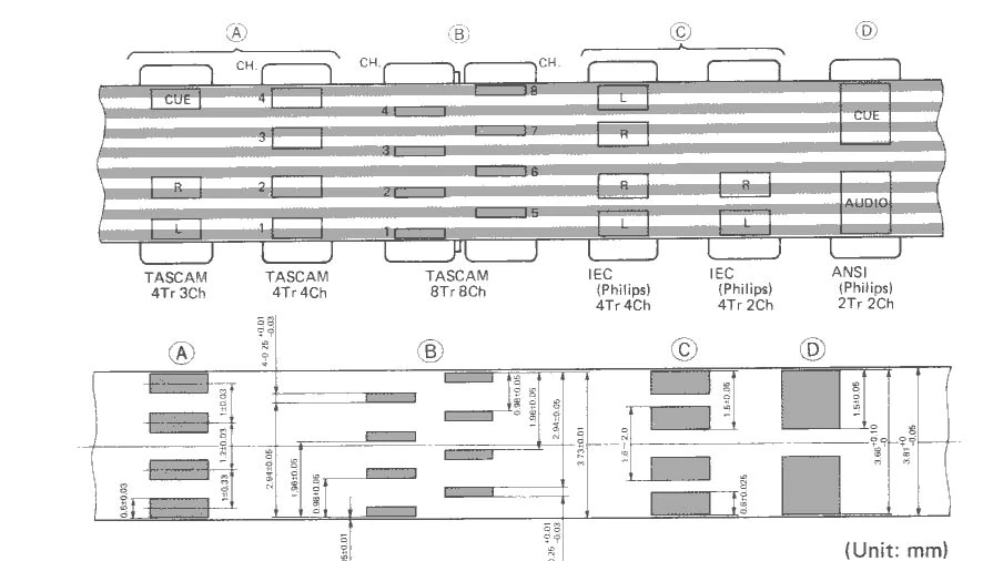

I just found a track diagram for the 238. The record tracks measure up at 0.25mm and the guard tracks at around 0.23mm. Maybe could have 0.125mm record tracks and 0.1mm guards with the 16er?
I guess a less elegant solution would be to have two synced decks within one machine!

I once owned two Tascam 238 machines which were synced together with the Tascam synchroniser...with code on both machines, it gave you 14 tracks. The idea was to keep 'master' tapes from one machine and keep bouncing to the other machine for infinite one or two bounce recordings. The thing is, the sound was significantly different than an open reel recorder....even an MSR16 which probably has the same track width (or smaller). I moved up and up, and now have Fostex G24 machines and the Tascam MSR24...mainly because of availability of 1" tape when I was sourcing them.
Yeah the MSR16 would be vastly different than the 238...4x the tape speed and roughly double the track width as compared to cassette 8-track (the 388 and MSR16 track width is roughly the same as 4-track cassette, but the MSR16 operates at 15ips and the 388 at 7.5ips as compared to the 238's 3.75ips transport speed)...not to mention much higher output tape formulations and higher headroom amplifiers on something like the MSR16 compared to cassette tape formulations.
I knew it sounded different....now I know why! Cheers Sweets.....not been here in a while.
