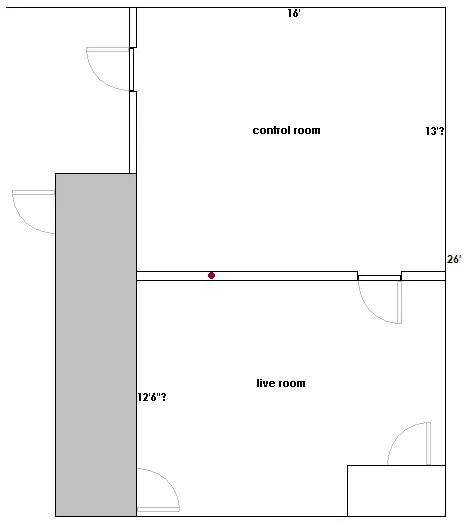

11.5' x 8.5'x 92" good modes???
  • Thread starter Thread starter role65
any ideas... other than my original drawing?
anything to look out for?
need more pics?
What effect will the block have on the sound even with drywall over it?
Ryan
Ok, how about this? What about not building out to the support pole(only out 1-2' for access to storage heater and furnace) but build the pole into the wall between control and live rooms.

ok my plan was to just use firing strips and probably no insulation between the drywall and block....I'm making an assumption that leaving the block exposed with several absorbers is a bad idea...
Panda on the drawing...
I need a way to (God forbid) to get my furnance or water heater out if need be... hence the storage...Your the pole is smack dab in the middle though i could build a wall like you suggest... let me try something real quick...

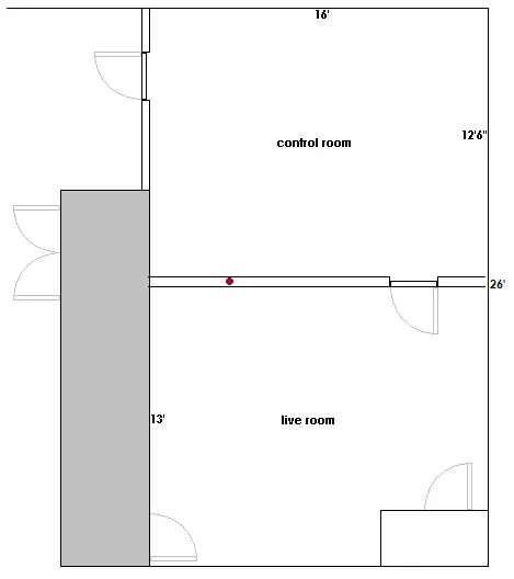

Maybe?
another thought... thanks to panda ... construction can be tricky working my main wall around. But doable...

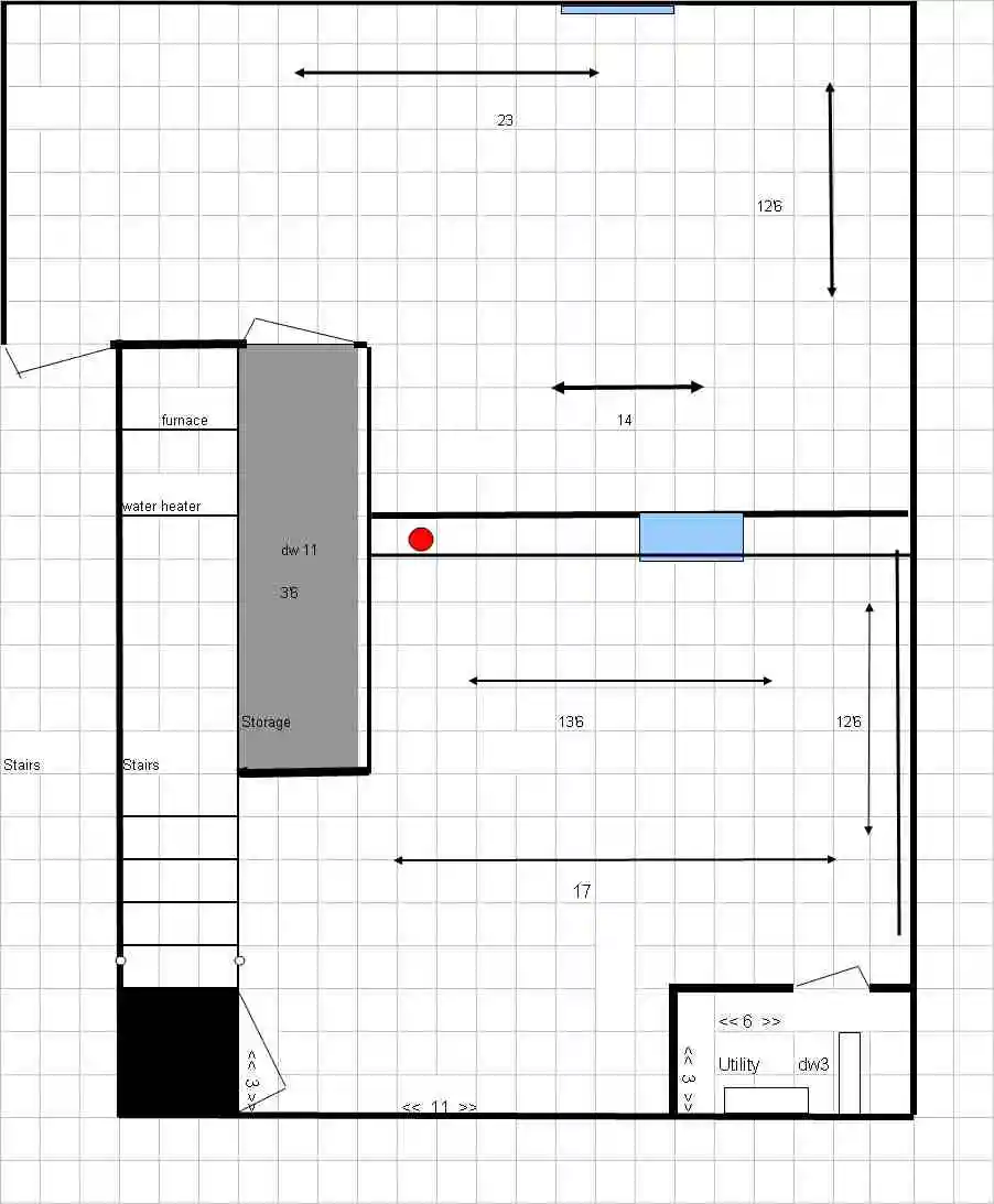

What about double doors behind the furnace/storage heater? Like so:

Panda appreciate the help. After sealing my block ( which has the most harmful freakin fumes) i realized the water pipes are just to noisy to use that part as a live room...
