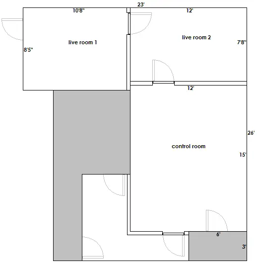

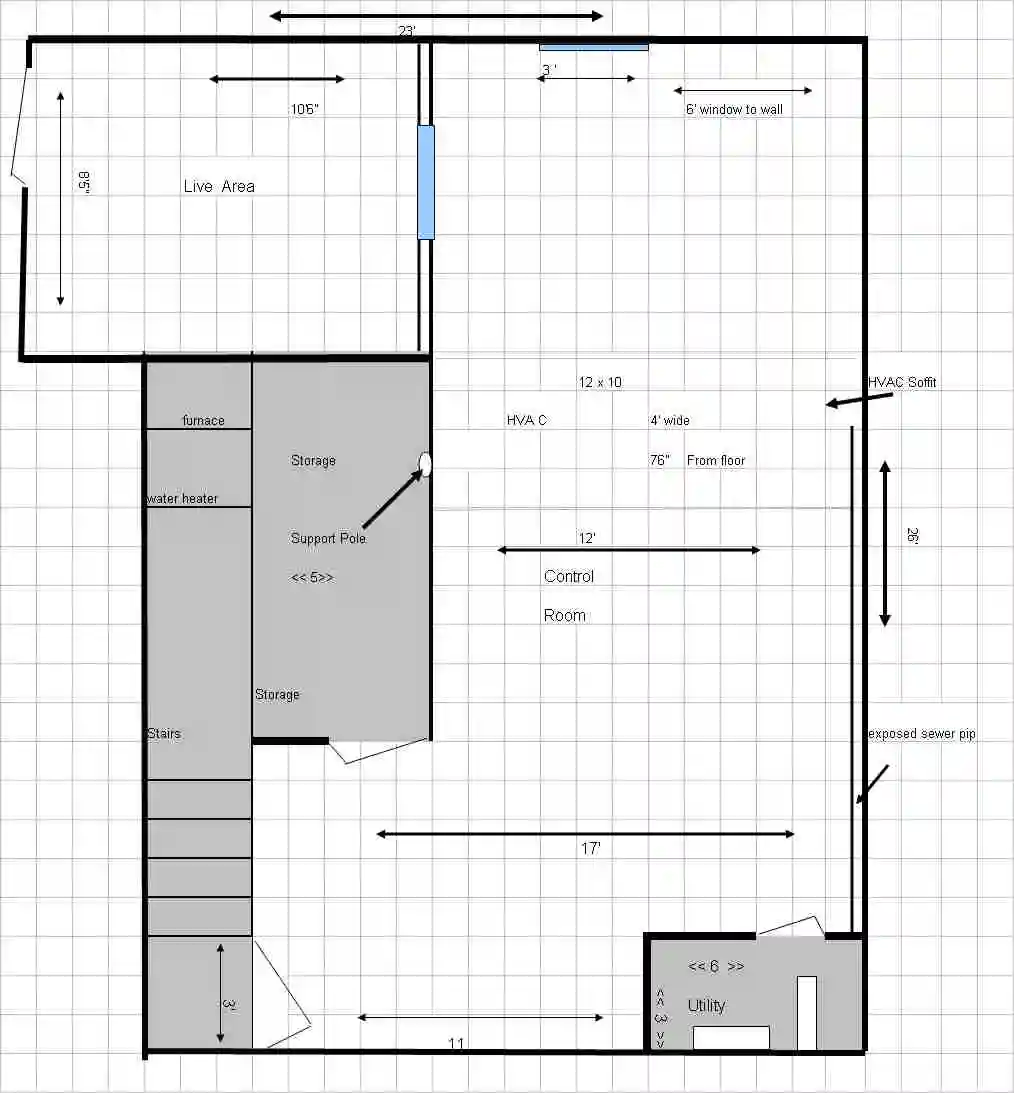

plans Don't laugh
Rick,
I tired sketchup, but couldn't quite figure out the 3-D stuff, so this is my basic floor plan in excel.
The parts in gray i have to work around there is a storage area which has the furnace and water heater, then i need to build another closet that would have the electric panel and the sewer termination. my HVAC trunk runs through the control room ( it's marked) so i will have to soffit that, and the sewer pipe that runs against the wall ( also marked). the drawing suck but gives you the general idea...
okay i'm still trying to figure out how to attatch since i can't use exel files and the word .doc is to big...
Ryan
Finally
OK revised Plan...
The image quality is not great, but hopefully you can make it out...
I tried to be specific, but I know you'll have questions.
Thanks guys...
Ryan
Ignore the 12 X 10 dim in the HVAC area... misplaced dim
Sorry
Ryan
Can you post a few pics. Its difficult to understand your HVAC stuff.
OK revised Plan...
Thanks guys...
Ryan

How's this?
Truly soundproofing those spaces will not be inexpensive and needs to be done during the framing stage. You also need to consider electrical 'holes' and HVAC as part of the solution.
Bryan
Yes panda you have had designs i have been kicking around since last march...
I will try to take some picks tonight...

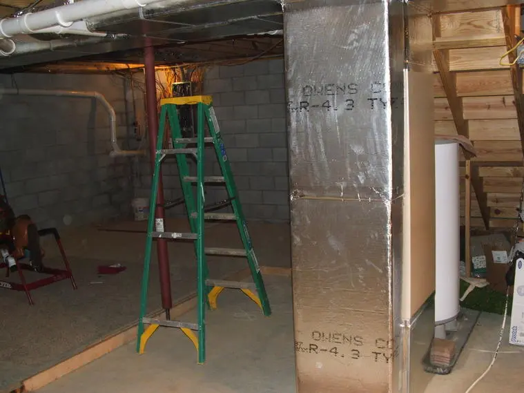

the Hvac "soffit" is the main trunk and return. along with the line set and sewer drain pipe... I ran it all together so "one" day when i finished it i could just soffit around it..
I was really thinking of Fitz 's advice and making a larger control room and have 1 drum room more or less... I have like 30 office cubicle's that seem to have some kind of rigid fiberglass in the middle of them so i was thinking of adding some 703 and using GoBo's at the tail end of the control room if needed....
P.s. I think i can make the "live" room a little longer ( there is another half of the basement no represented on my sketch) maybe 14 x 8 or so...
also only wanted to keep it 1 live room for costs, that's the only room i'm concerned with sound "dampening". i know i am not going to proof it just want the roar of 110dbc down to like 60...
Ryan

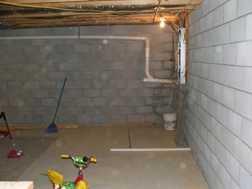

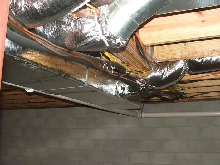

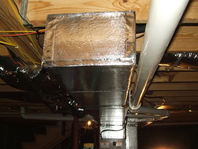

Basement Pics
I tried to title the pics as too the view. ie CR entry would be the view as you walk into the CR door, Storage would be through the storage door, etc..
again ask questions i'll try to answer quickly thanks for the help...
Ryan

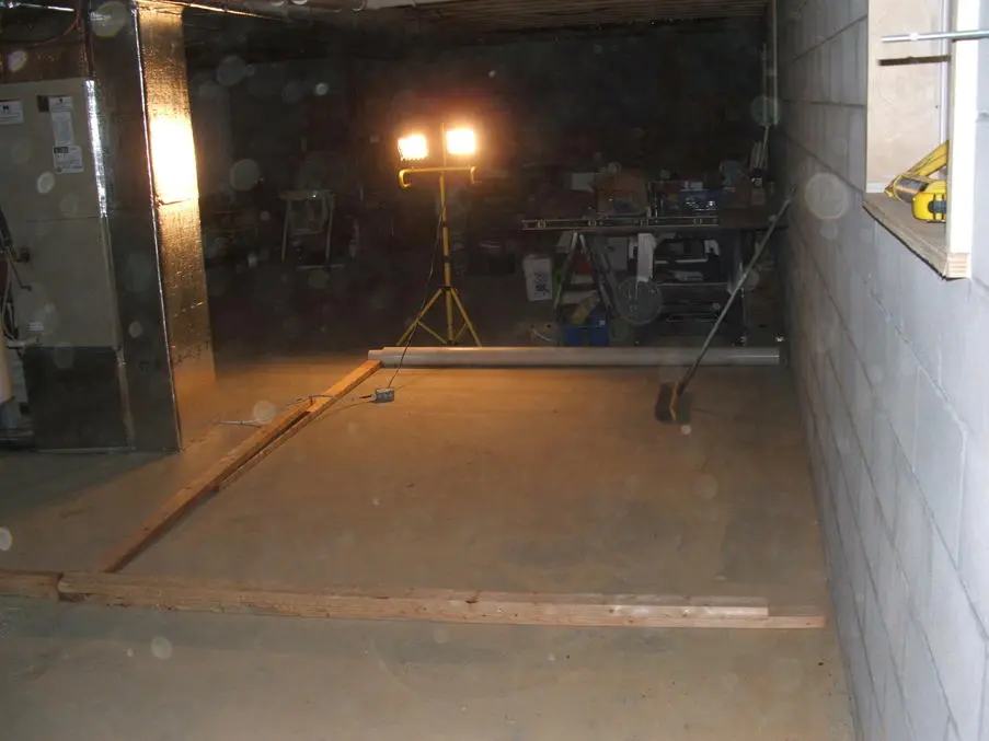

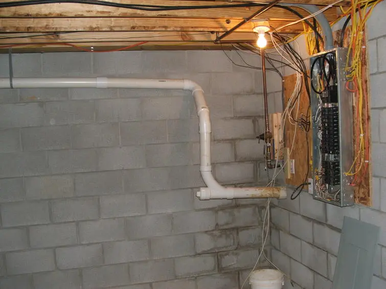

ok pic title's aren't shown..LOL
pic 1 is CR view into the live room
pic 2 CR entry from stairs
picc3& 4 Hvac showing why i need a soffit
more pics
I'll describe pics next post...it's changes the order in the post...

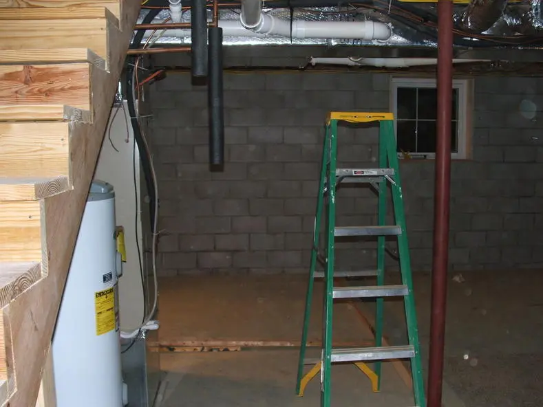

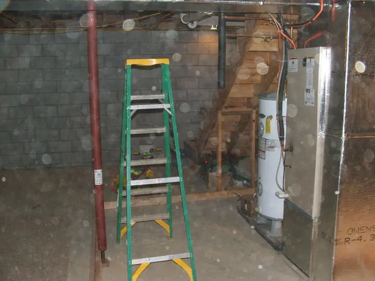

ok the first 3 pics show the Storage area "grayed" out on my sketch... also notice the support pole that will be in the wall
Last pic be the utility closet as well as a soffit i have to put around the drain pipe...
Also notice the 2x4's on the ground representing walls...
Ryan
