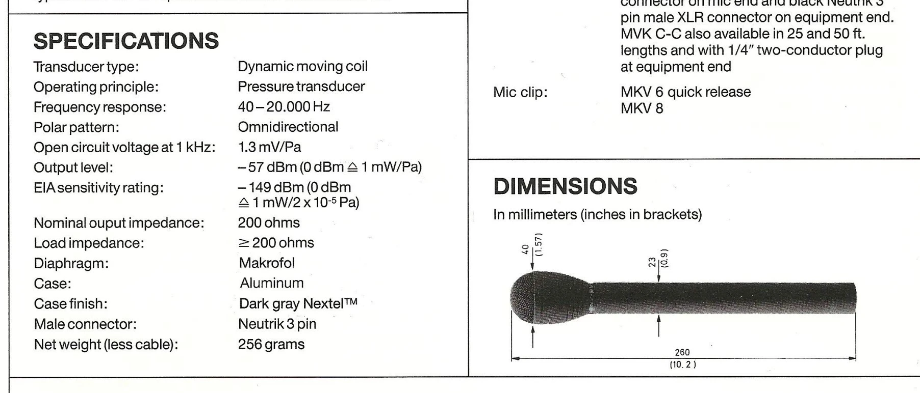

Try a Beyer M58. Excellent for spoken word. Omni.
@ Lazer
That Beyer M58 is $200 used. The OP was targeting the $100 range. My friend will not drop 200. I would, he won't.

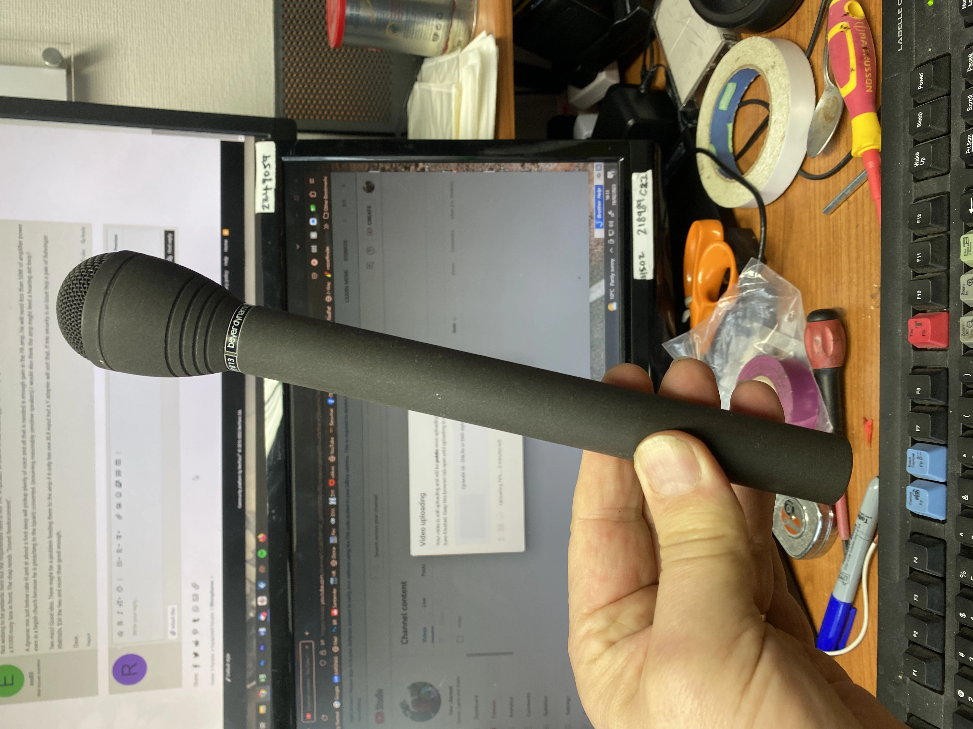

The M58 is a fine mic, but it's horrible used for anything amplified, and it is very long too - handy for interviews but not very good for the purpose here.
