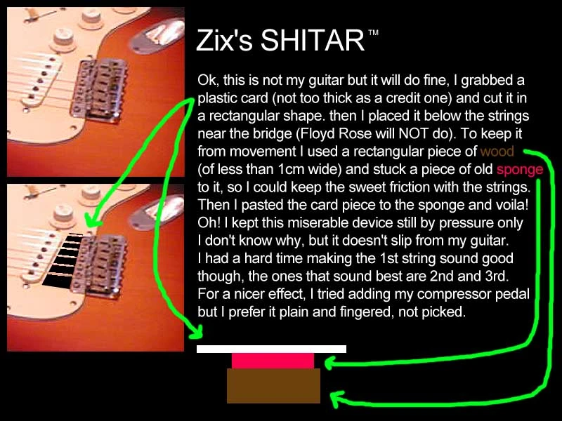

Well as promised...
Let me introduce to you...
"The SHITAR"™
Hope you enjoy it as much as I am enjoying it...
If there's something that you don't understand, post it, i'll try to help. (Maybe the scheme is not so clear at all, I had to figure out a clear enough explanation in english...sorry)
Peace...
PC

Be sure the card is just barely touching the strings, if you press it too much against them, the effect will not be so cool...
Measure well before building it...
