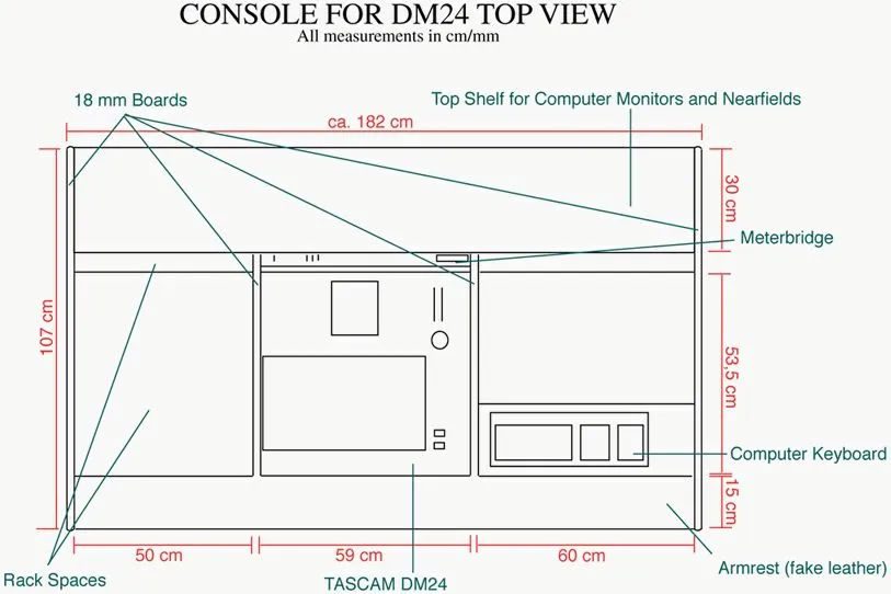

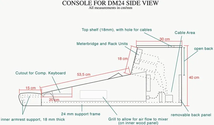

Here are two pics (rather large, I´m afraid) of the first plans, so you get an idea.
Note that a) the measurements are all in cm and mm, so you will have to divide by 2.54 to get inches, if I am not mistaken and b) that the measurements are not totally accurate.
We are not sure about the legs and feet yet, so they are not on the plans.
Christopher

... and here is the second one.
BTW, this is for the new TASCAM DM 24 mixer...
Christopher

That's VERY simaler to my set up except on either side of the mixer is 19" equipment bays and the computer keyboard/mouse is on a pullout under the portion where the mixer sits.
@ TrackRat
I know.... Maybe you could share your experiences with that specific setup...for example, do you wish you had done something differently etc..
As far as my plans go, I did not want to go for the pullout option, since I wanted the top of the armrest to be at "normal" desk height (75 cm) and then the keybord would have been too low - leg/space problems.
The only option to work around this would be to have the keyboard slide into the armrest and I felt this was too complicated. :-)
If I need to do a lot of typing, I can always just put the keyboard on the armrest in center position.
Another thing I wanted to have was "clean" space for scores etc, so that explains the "empty" zone above where the keyboard will be...
Most of my outboard gear will still be in racks behind me, but I wanted som stuff closer to, like a Lexicon Unit etc...
any other thoughts?
Christopher
I know what you mean about the pullout but I wanted the patchbays to be in the equipment bay to my left. Also putting them on hinges, while a little tricky to engineer, made wireing and maintenence a hell of a lot easier.
Man, I love that hinge approach! May I plageurize it? Although I will sorely miss crawling behind my board and holding a flashlight in my teeth while I wrestle with a jungle of wires!
No, you may not. Plaese send a royalty check to me right away.:D

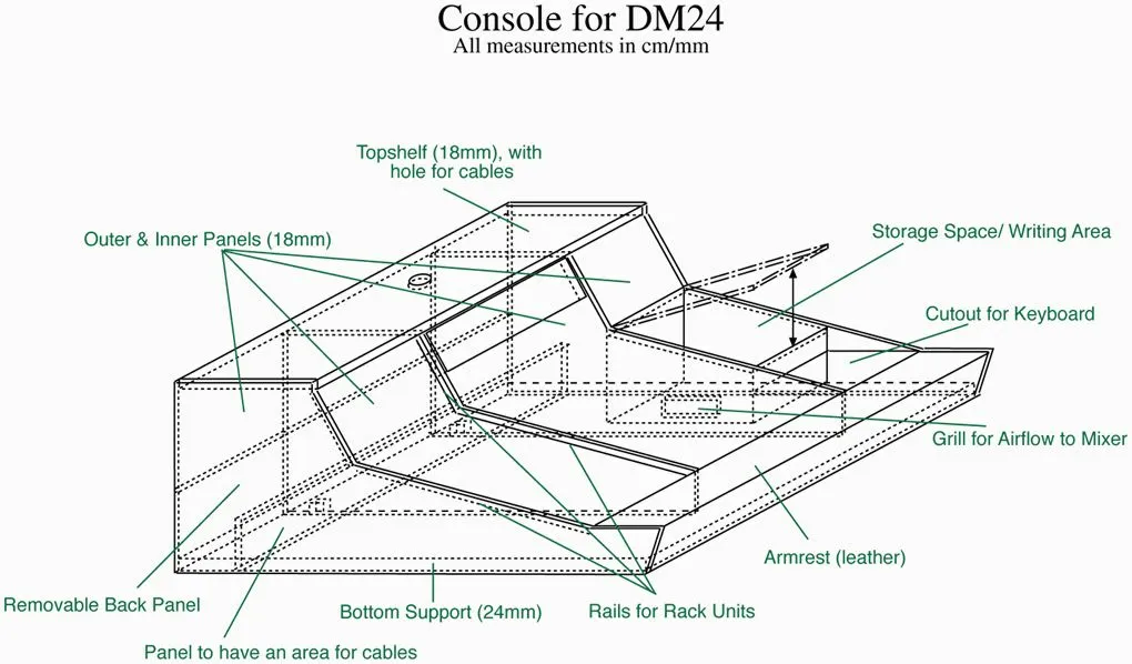

One more pic... kind of a 3 D view, although the dimensions are all screwed up. But I think one gets a better idea from this view.
Christopher

Ausrock, that's one of the reasons I'm changing the racks under mine; to get a better median plain on the nearfields (to get the tweeters at eye/ear height from a seated position. Now they're just a little too high, like me:cool: ). Also the top shelf where my nearfields and computer monitor sets on is hinged to access the internal wire harness for maintenence/ upgrades.
CD, the more I see of your design it's close to identical to mine, which so far (except for the refinments I want to make) is working really well for me.
That design looks pretty nice...
One question I would have is the wire hole in the center of the top shelf. I'd hate to have my near-field speaker wires all running along the top of the console just to go down a hole in the center... is that what that is for? Would it make more sense to put two holes (one behind each monitor location?)
Just asking...
