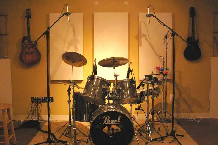

Sorry for the grainy pics--the ISO settings on my camera were cranked way up and I didn't realize it until after I shot these.
Before we get to the pics: I haven't mentioned this because I assumed it goes without saying, but just in case it doesn't I'll say it now. These drum tracks are in no way raw.
The room is new, but the mics (well most of em), the kit, and even the drummer were all used on a double CD I recorded last year, so I had a serious head start on what each piece of the kit needed. I rely on the overheads for the overall sound and balance of the kit. So my overhead tracks are the least processed: a touch of compression and that's it. Not even any EQ (I like the mics!). But all the close mic tracks are fairly well processed: EQ, compression and gating on all of 'em. In each case the close mic track by itself would sound like crap. But I'm pushing the close mic sound to give the "oomph" and "punch" that the overheads lack. When combined, it works.
First up--a front shot of the whole kit. The overheads are a pair of tube SDC's I got from a group buy a couple years ago. Don't know what well known mic to compare 'em too. I personally find them comparable to my Rode NT5's, but a tad warmer. I use the Rode's on my acoustic and leave these on the kit. You'll notice a third SDC (in the back corner on the right). I used that to pick up the timbales. Josh (drummer Josh, that is) likes to add them to the toms on fills, so I needed some extra pickup to complete the sweeping stereo effect. So I used a third overhead right over the timbales, panned it hard right, and edited out everything where he wasn't hitting the timbales. A couple more close mics would be easier--that'll be next.

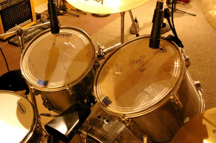

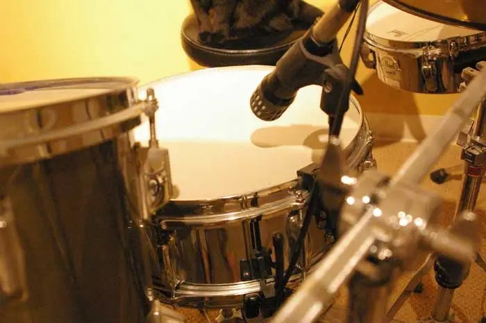

Toms and floor tom. All three are mic'd with GLS ES-57s. Thinks Shure SM57 with a bump slightly lower. The mics on these are all placed in much the same way.

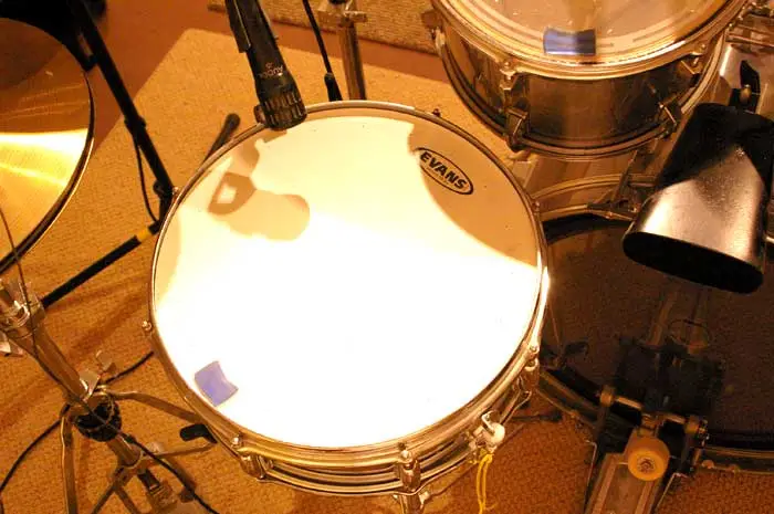

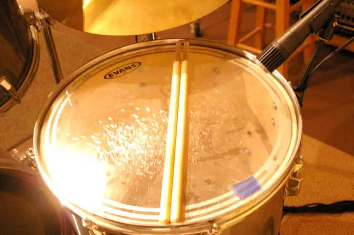

Snare. Mic'd with an Audix i5. I've gotten similar results with an SM57, but moved that to an amp. I don't think these pics show it, but there's a mic on the bottom of the snare. I was convinced that having that brighter snare wire sound to mix in would be a good thing. So I tracked these with two snare mics. I tried every damn way to combine 'em and the second mic just never added anything valuable to my ears. Besides, I'm going for more a "pop" than a "smack" and between the overheads and the i5 on the snare top--I'm happy. So I didn't use the snare bottom mic at all. Cool--frees up another channel!

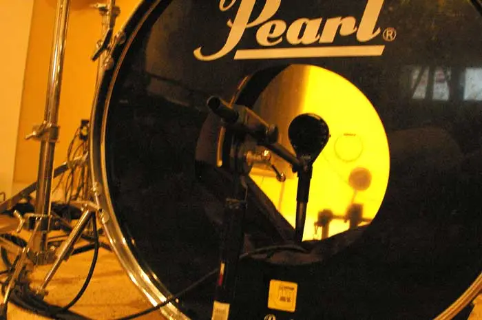

Kick--mic'd with a D112. This pic is pretty crappy, but it's just off center, about 4" away from the batter head.
