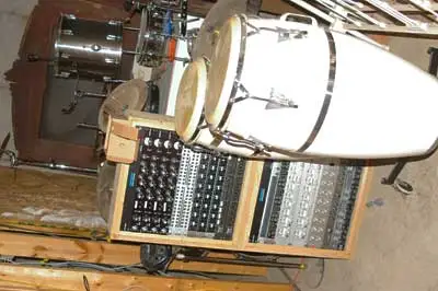

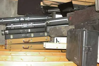

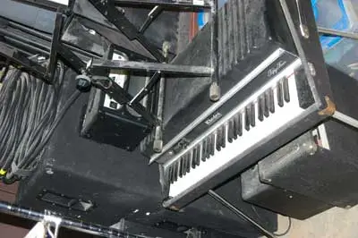

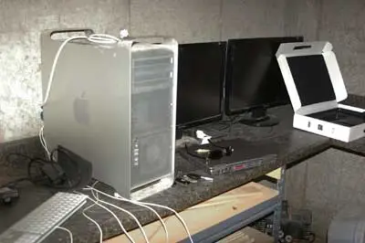

This is sad...all my gear stacked everywhere in the basement. Mics and rack gear all boxed up, amps buried, keyboard strewn about (yeah, I know--I'm gonna cover 'em)

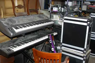

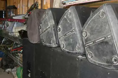

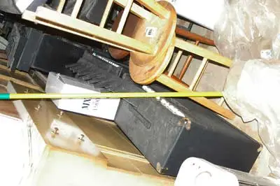

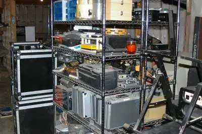

More crap all about...speakers and kitty kats, the guits are put to bed, drums and percussion, and my computer--in the workshop?? (okay that's going upstairs until we're done)

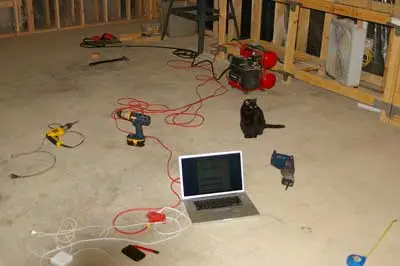

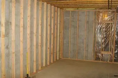

Okay...it's been just over a week. All the framing is done and insulation is all in place (walls that is).
I ran new electrical circuits (including one just for the desk), and pulled midi cables and audio snakes through the walls. Even though it's a one room studio, I can't stand wires everywhere, so each wall will have a built in panel with an array of mic and instrument inputs, and monitor and headphone outs--so each wall needed a 16 channel snake run through it.
The desk end of the room will have an elevated floor (one step high) so all those cables can come down through the walls, under that floor and up into the desk--and remain invisible. That floor is built now too. Two of the four walls are completely sheetrocked.
Tomorrow--finish the sheetrock and start mudding and taping. And then some BBQ. Oh yeah--I took some pics--I'll post them tomorrow as well.

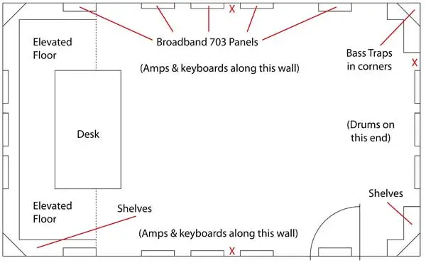

Before I post more pics--here's a little general background on the room. I have tons of 3D elevation drawings that are all on my "big" computer, unplugged and sitting in the other room. Too bad I don't have 'em on this laptop.
Anyway, the room is 16' x 26', and it's in the basement. I've been using the space--completely unfinished--as my studio for about 4 years now.
The drawing below shows the layout (in 2D at least). The cool thing about using the unfinished space as a studio for as long as I have, is that the placement of all the "tools" has evolved to serve me. So nothing is guesswork. Everything on that drawing has been there for some time--just in an unfinished space. So I've been able to see what works for me and put things where I like them. As much as this has to sound good--it has to work well. I want to be productive when I've got an idea worth recording.
First, it's obviously a one room studio. This space is only a small part of the basement, and I could have a two, or even three, room studio--complete with a separate control room--but that doesn't work for me. I'm the first and most important "client" so I want to be right in the room with all the toys. So the control room idea was out of the picture from early on. When I am recording others--I've learned to sit quietly.
The drawing is fairly self-explanatory. Everything's there except for ceiling height. Unfortunately, it's only 8 feet. When I built this house a few years ago, I planned on finishing the basement. So I was careful in my design of the basement. The house is a big "L" and there's a main load bearing wall running down the spine of that "L."
In order to protect the look of the finished space of the basement, I designed all the systems so that everything unsightly fell on one side of that main wall. Everything that drops below the floor joists--plumbing, electrical, HVAC, central vac, RJ11, RJ45, CATV, is on the "to be unfinished" side, which takes it down to 8 feet. The "to be finished" side of that wall is 9 feet high. That means my finished basement will have a nice 9 foot sheet rock ceiling--and thus look a lot less like a finished basement.
The problem is, in a fit of selflessness, I designed it so that my studio goes on the "to be unfinished" side. Of course, I'm finishing the room, but that means I have to go with a drop ceiling. At the time, I was just happy to have a decent sized room--drop ceiling or not! Four years later--I'm feeling greedy and wishing I had taken the whole basement! After all, we've gotten by just fine without a finished basement so far, right?
Anyway, I'm sticking to the plan. And it's not too bad. The drop ceiling will start at 8 feet, the joists start at 9, and the floor is at 10 feet. I'm filling the entire gap between the drop ceiling and the floor above with insulation. According to my calculations, 24" of insulation is worth about 6" of 703 (not to mention my acoustic tiles), so in effect, my entire ceiling will be an acoustic panel cloud.
The only thing not spelled out on the drawing are the three red X's on the side and rear wall. Those mark where patch panels will be on the wall: 16 channels each; 10 mics in; 2 XLR out; and 4 TRS for instruments and/or headphones. This decision comes from using the space before finishing it. I can't stand the mess of wires and cables that accumulates in front of the desk!
So each wall will have it's own panel. Drum mics, guitar cab mics, vocal mics, you name it--they'll all go into side walls. Those panels will be connected via 16 channel snake cable (the blue cable in the following pics) through the walls, then from the walls they'll run right under an elevated floor section in the front of the room, and straight up into the bowels of my desk.
A pain in the ass to solder and connect it all up, but the more connections I have ready to go, and the less wires I see--the better! :D
Oh yeah electrical: a new 20 amp circuit for guitar amps on the walls, and a new dedicated circuit just for the desk. You'll see the yellow romex in the following pics.

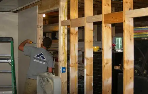

My son working on drywall. Go AJ!!! He'll never read this, but I gotta say it--this wouldn't be happening without him. Thanks dude!

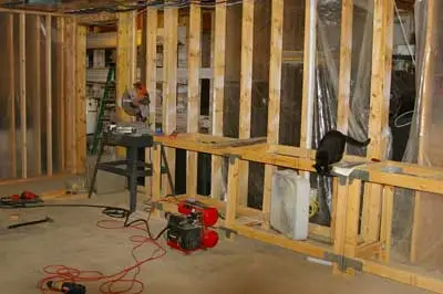

This pic shows another cool feature. Notice the "cross beams" between the studs in the wall that's not yet covered with drywall. All four wall have that running for their entire length. Between 703 panels and wall-mount guitar racks--there'll be something hanging most everywhere. So rather than mess with drywall anchors or looking for studs, we ran lumber horizontal throughout the whole room. (Again, base on where I had guitars and panels hanging in the "unfinished" space.)

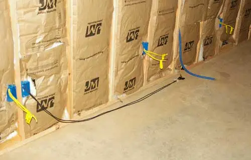

One side just before drywall goes up. The blue wire (my son calls it an Avatar dick) is the audio snake for that wall. The black is MIDI (my main controller goes on this wall) and of course the yellow is electrical.
Notice the insulation: I'm not going for soundproof at all. I live on 25 acres in the middle of nowhere. Except for my wife, there's no one to piss off with loud music. I am however, filling all the walls (as well as the ceiling) will standard R13 batt insulation. It's cheap, and if it gives me even a smidge of broadband absorbtion--hell, I'll take it. (Helping manage the temperature wouldn't hurt either).
