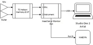

After fussing with my setup a couple of weeks on and off I finally got my rig configured well enough to capture some guitar and vocal successfully. Granted I have some coordination issue with the timing of guitar, voice, effects peddle, etc but i'm very please right now with the results.
What is a bit annoying (I haven't noticed it effecting the actual recording yet) is a bit of a hum that is obvious in my monitors. Now I have been able to mitigate this a little by turning down the inputs on the AudioBox USB. However this also diminishes the amplitude of the source inputs and consequently the recording.
Here is my setup..
So the questions I have are...
  1. Since I had the hum in computer speakers attached to the AudioBox USB is this a typical issue with the device?
  2. Is there any way to get rid of or filter out the hum other than reducing the input levels?

Sounds (and looks!) like a classic "laptop+AI+monitor" earth (aka ground) loop problem.
One sure fire diagnostic: Unplug the charger from the laptop. Does it hum on battery power?
Let us know.
As you say the hum is rediced when you turn down th egain on the Audiobox, I would think the problem is from the output of TC Helicon - maybe hte impedances don't match up to the interface. Try plugging your mic and guitar directly into the Audiobox and see if the hum is still there.
Note hum was present before the Harmony-G XT was added to the configuration.
Dave... will test and get back with you on the power supply.
...Kip...
Just dropped power (AC cord on external ps not the plug in the back of the laptop) and it made no difference to the hum.
Regards, Kip...
Okay I have done the following with the following results:
* Unplugged the power supply back of the laptop - hum still present
* unplugged all unnecessary USB connection - hum still present
* disconnected the Audiobox USB's USB cable - hum Stops
I'm noticing more hum on the right port than the left (2 vs 1 the instrument input). Port 1 (voice) does hum if turned up but not as bad as 2 does. Seems like I ran across something regarding the UBS cable itself that connects the AudioBox USB to the computer being an issue at times but can't find those websites that I found it at earlier.

What sort of hum level do you get with no mic and no guitar plugged into the Audiobox?
Should be none or very little even at max gain.
Hey Dave,
I unpluged and the hum is still there. Even turned off the Harmony-g xt still there. It seems to be definitely related to the AudioBox USB or its USB cable. both of which I can eliminate the hum by unhooking but then I would not get much recording accomplished either. I"m half tempted to switch the setup over to my desktop computer and try that but I really wanted it on the laptop for portability.
Do you get the hum on headphones, i.e. with the PA disconnected?
And can you describe this "hum" or better yet attach a 10sec .wav clip?
I have a PA system connected to my recording gear as well. Across the room on a different circuit. Hum nightmare. A simple Behri HD400 solved the problem.
Dave, little ironic but they don't allow us to up load sound files only video and pics. I have a 15 second or so recording of it in wav and MP3 but can't put it up here.
On the headphone bit. As i fully expected same hum there as well. Now what I did notice when I went to reach for the plug to undo it is that the amplitude increased as my hand got close to the jack so it would seem like some form of RF energy generating the hum. I hooked up the PA and did the 'reach test' again and the same results for the PA as well. If you have a suggestion on how to upload one of the sound files I have them saved on my machine now.
