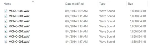

I have an R24 and with a 16GB card I have recorded 6 hours of 7 channels - 44/16 audio. It all depends on your SD card. The files were 1.8GB each. Total size of 12.4GB. The jam started around 7pm. We finished at 1am when I hit the stop button. Interestingly it took a bit to finalize all the files and shut down. Note the time stamps!
What size SD card did you use?
I did however find a reference in the specification to a limit of 1GB for the R16 per track. That would be 200 minutes with 16 bit, or 133 minutes of 24 bit recording. Page 96 of the manual. However, the same spec is noted in the R24 manual, and clearly I have been able to exceed that. Perhaps there was a change in one of the updates. Maybe that spec refers to 200minutes per 1GB, so a 16GB should yield 6 hours.
You might check to see if you have the latest firmware version.
