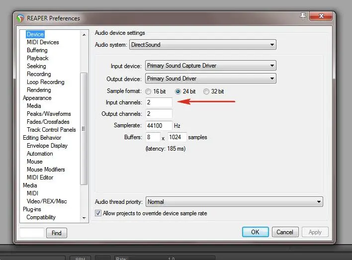

I don't know your software, but perhaps in the preferences/options there is a place to setup how many channels the software will recognize. Below is a screenshot for Reaper's setup box for audio. It's presently set for 2 channels, but can be set to an appropriate higher number when I have a Tascam US1800 connected.

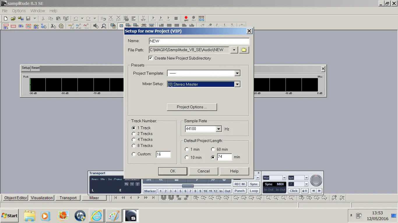

See the attachment, comes from, Open Sam, New Project...drop downs set track numbers etc.
Good thought but I tried that too. My default for a while has been 8 track to match the Zoom inputs.

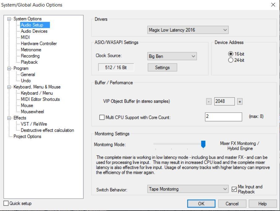

But... If you choose the ASIO driver called "Magix low latency 2016" it works!!!

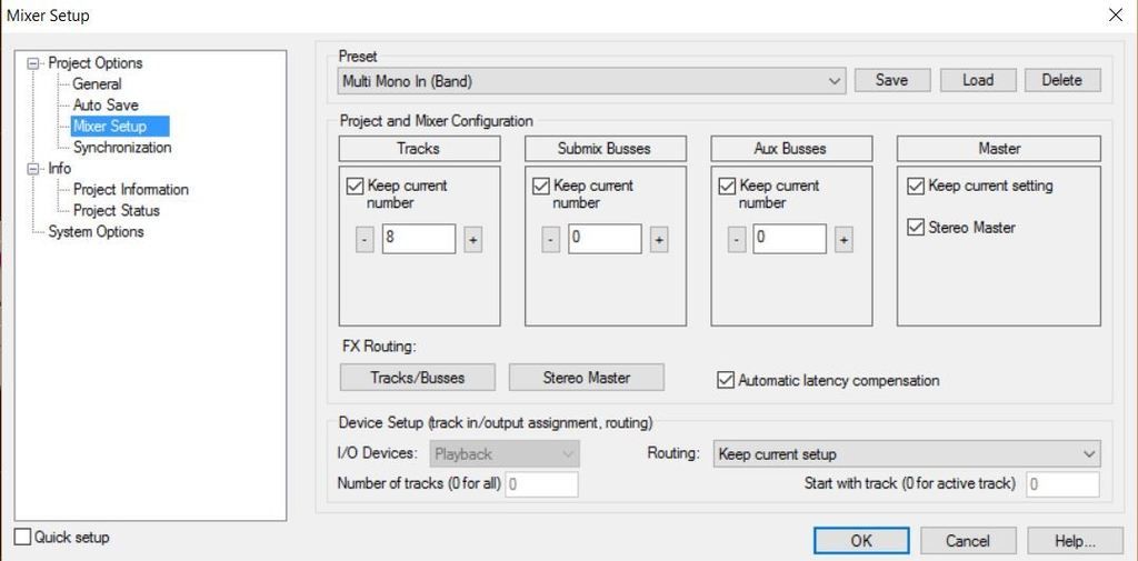

Then you go to "Project properties/Mixer setup" and choose "Multi Mono In (Band). This automagixally (groan) maps channels 1 - 8 to tracks 1 - 8 in the DAW.
