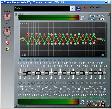

Not sure if this is even useful, but I'm an adventurer. On my travels within the nTrack software, I discovered this wonderful thing called a Parametric EQ :D.
Anyway, pushing the Left and Right side frequencies opposite each other about 3db, it provides a widening effect. Not sure why. I've used it on individual tracks, and whole mixes. It was added before the actual mixer settings in the chain. See attached image for example.
You can also make variations of this using a range of frequencies.

scrubs-good to mention not to seperate thoes tracks
david-that idea may play hell in mono (some people don't care)
