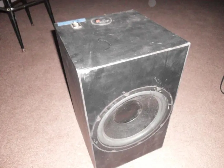

Here is mine. An old subwoofer I had lying around. Sounds great though requires a 10db pad.

Like Jimmy's! And I do remember now that just about everyone said that they had to pad them.
I'm thinkin' Jimmy pretty much has it nailed- press an old sub into "reverse signal direction" service. Gee, what could be easier?
Yeah, and when its not being used as a mic, it goes back on one of my reference stereos. Dual use. :)

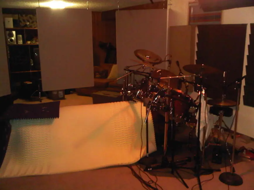

Nice! I have found my subkick to work best building a tunnel and placing the subkick at end about 6' from the kick. There is a kick shell at end with 2 1" PVC layed across with 2 sleeping bags and that foam bed thing draped over. Ghetto as hell but does the trick nicely. :)
Obviously the polarity needs to be flipped. Subs galore.
