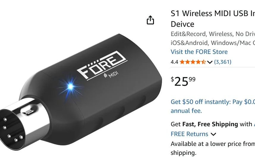

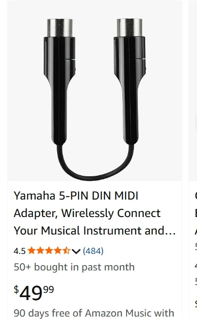

Out of the midi bluetooth devices the best one I found was the Yamaha BT-01. It is powered off the unit's midi port directly. No batteries. No charging.
Yamaha's bluetooth midi has been found / identified, and worked on every computer and operating system type I tried.
Fore's S1 worked well also. And is a more budget friendly option. Less simultaneous features. No 'in' and 'out' at the same time(sounds dirty but it's not).
1st place Yamaha BT-01
2nd PLace Fore S1
