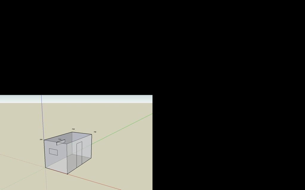

Hi, Nickd,
here's a quick scetch.
All the walls except the east wall are exterior walls. The walls are open framing on the inside. 2x6 except the south wall which is 2x4. Above the cieling is the laundry area. Open2x8 joists.
Was thinking of filling the framing bays with 1" rigid followed by r-13 paperbacked fiberglass, Folled by 1/2 plywood, followed by limp mass vinyl
(loved their first album) followed by 5/8 sheetrock. On the cieling, i'd skip the plywood.
I was going to make 4 vertical coloums of minerel wool or acoustic cotton
in the 4 corners. maybe 4 inches each. I was going to put broadband absorbers ( same material?) across the inside of the door and opposite under the window.

sounds too complicated. why not just some 2" fibarglass board? Is soundproofing all that important? I thought you wanted it to sound good in the room.
Remember, sound proofing and sound treatment often work against eachother....
Seems like there should be a stratagy for keeping sound from getting out,
adding the right amount of shear strength to walls, allowing vapor to escape, and absorbing the right amount of bass. Maybe someday there will be a single sheet of material that will do all that.

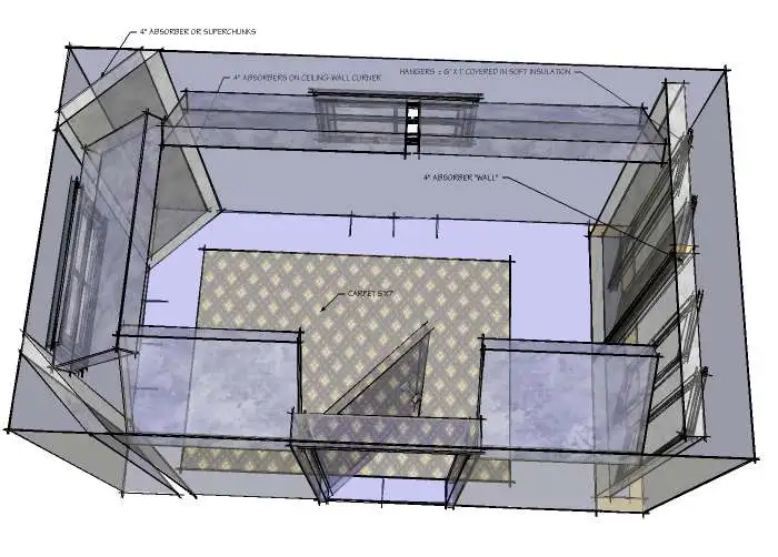

putting the absorbers on the ceiling-wall corner will help conserve floor space. also consider giving up a foot of space on one end to build some bass trapping - i.e. make the entire wall a good bass trapping setup. its only a foot but would help.

Hey,
Thanks, Glen!
Cool drawing, too.
That's kind of what i was afraid i would need to do. I guess a smaller room is better than no room! (what i have now)
Do you think the bass trap wall in your drawing would be best placed
on the wall opposite my monitors, then?
And what would be better; mineral wool, acoustical cotton, or 703?
thanks again
I think you use 4" of 703 and put in some 1/2 or 3/4 plywood (wrapped in soft insulation) hangers to try to add some more trapping in that space. if you can spare a cloud over head - but 7' is pretty low already. you don't want to wind up with a dead room even if its small. plus I think the cocktail kit bass "drum" is probably not a much a problem. keeping the volume levels reasonable will help... yeah - put the monitors on the side opposite the bass trap.
joists
i just noticed that you mentioned 2x8 joists.... this is great for treating the ceiling if you don't need sound*proofing*.... get some 703 or equivalent up in there!
edit: cover w/fabric, though! f'gls is bad fer ya. ;)
