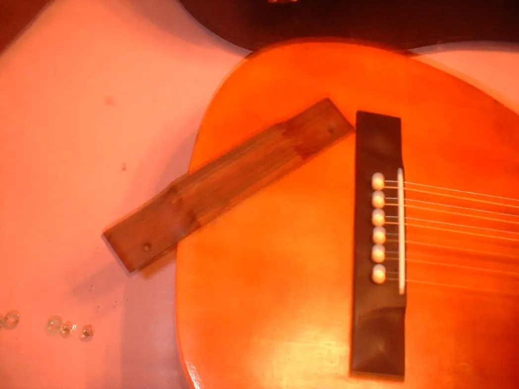

This fellow is in his late 60's and probably not that well off. So I told him to leave it and I'd see what I could do. So I took it in to work (I work for a guitar co.) I got a scrap piece of ebony and made a new bridge for it.
Someone had glued a "string-through" classical bridge on it that was way too tall. Not to mention they had two small screws attempting to hold it on.

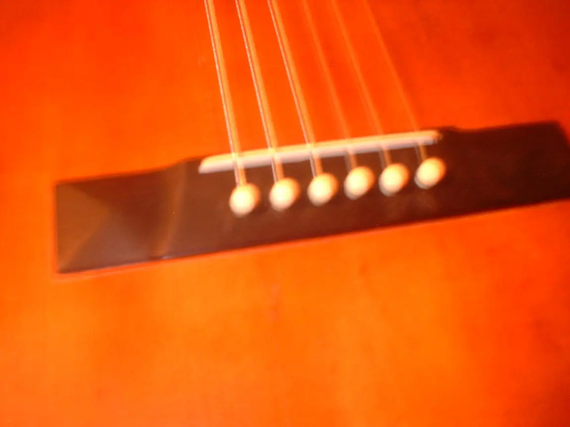

The new bridge is a "Pyramid" style, like what was used on all the examples that I found in my search. It turned out really nice. I'm not going to charge him...I enjoyed doing it. Maybe he'll hook me up with a box of steaks or something.

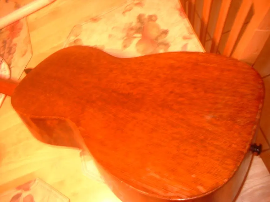

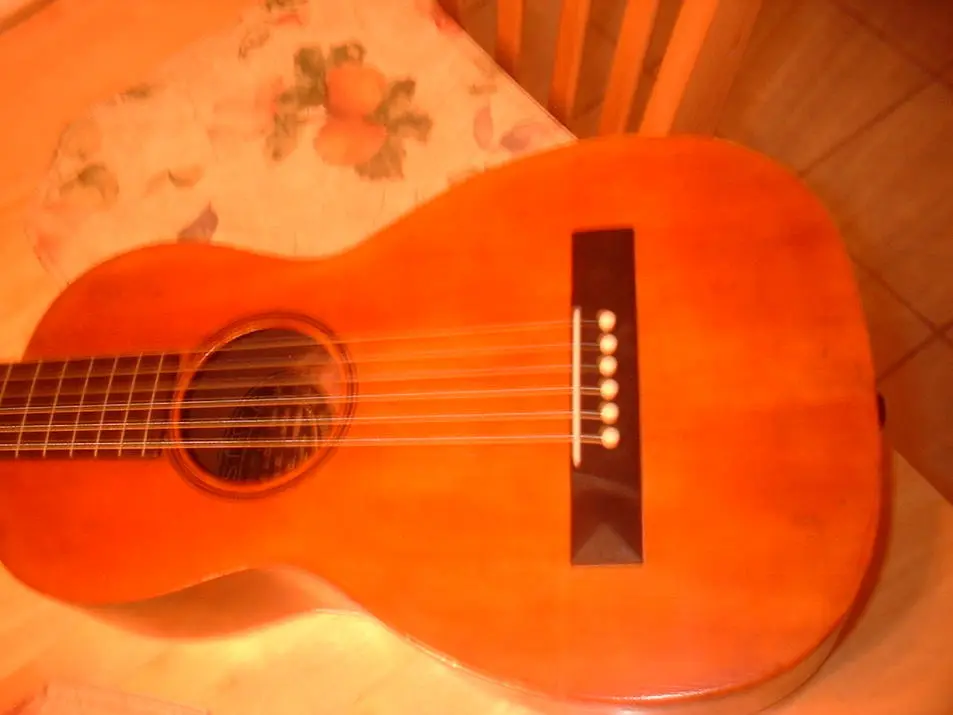

Well, I got it all strung up and it sounds pretty cool. Surprising amount of bass from such a small body. The action is a little high because of a rather steep neck angle but not too bad. Intonation is off a little. Over all it looks great and sounds pretty damn good for a guitar of it's age and wear and tear. My delivery guy came for it this evening and said his wife would be thrilled with it.
After a short argument over me refusing payment for it. He thanked me profusely and returned from his truck with a box of chocolate sundae cones,(something he knows I treat myself to.) -we're square.
P.S- I found our old digital camera (which sucks) and snapped a few pics of the guitar before he picked it up. I just have to find the software for it and re-install because we removed it when we bought a new camera. My wifes got the new one out of town with her and won't be back for a week. I'll try and get a few pics posted soon. I'm quite proud of how it turnded out.
pics
Sorry about the quality. Now I remember why we replaced this shitty camera.
