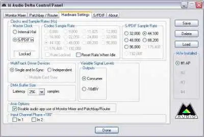

And Ya Golden, I do this, the tab is called "Hardware settings" and you can open the delta control panel by digging it out of the windows control panel or double clicking the delta icon in your system tray, if explorer hasn't crashed on you "this boot", it doesn't reappear after a crash.
The setting is in the top left corner in a frame labelled "Master Clock".
