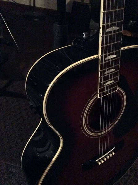

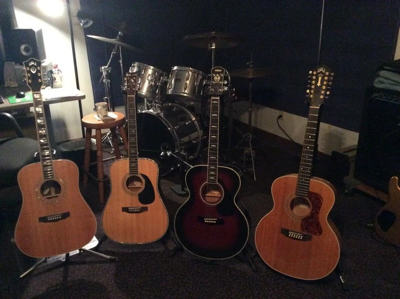

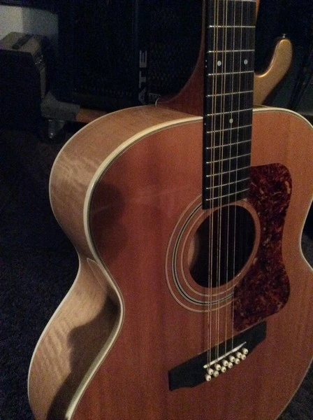

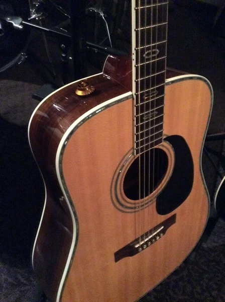

Just wanted to resurrect this thread for a moment. Got my instruments back, the first three, two weeks ago and the D-55 last week.
The repair guy did a splendid job on all. All are set up with low E at 5/64" and high E at 4/64" at 12th fret. Nice action!
In case anyone gives a rat's ringo, iI've attached these photos. Hope I get them sized right this time. We'll see.
If you see this jimistone, I know I somewhat mutilated the D-55 but not really. Turned out very nice with the bridge wood trim, plays like a dream, sounds great, and I am finally realizing the difference the ebony board makes on an acoustic.
Thanks arcaxis, for turning me on to FastStone Photo Resizer. Hope I figured out how to use it right!

Love the Gibson top hat knob. :thumbs up:
Yea, that knob's atop a pot. Had an underbridge p/u installed a few years ago and told the guy I wanted a vol control only. Works well. I just happened to have a couple of those knobs and thought it would be a good one for this.
There are some kind of electronics in there to make it work, not even sure what it is, but it has one of those stupid battery bags velcro'd up inside the upper bout. A real bitch to get to. Maybe I'll take a closer look to see what's in there next time I re-string.
