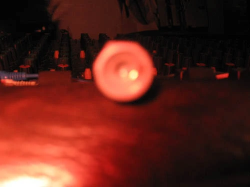

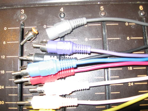

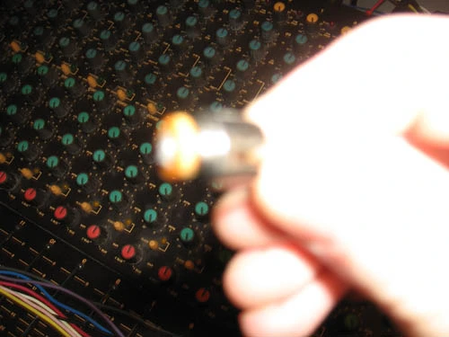

Okay, I've attached some pictures of the RCA ends of the snake. The gray one is the busted one and the black one is the other one I want to solder an XLR connecter to. I apologize for the washout in some of the pics, we have a new camera which has crazy flash, hence the red tint in the one picture (me trying to diffuse it).
So I posted this because I'm a bit confused. The RCA bit that came out looks like it has one solder connection on the end (broken off of course) and the cable it came from is just plastic casing, I don't see anything. I haven't cut the ends off yet of course, but it makes me wonder what will be there judging from what I see now. I'm assuming there has be two wires for a tip and sleeve in there though. Just wondering...

You'll probably find a center conducter with a braid shield around it...
