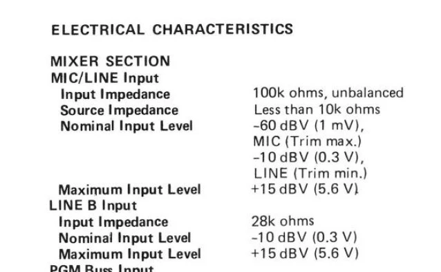

I do have an old Tascam 246 which is just an expanded version of the 244. Back when I was using it, I used Audio Technica (ATUS) type impedance matching XLR to 1/4" transformers which aren't too different than the Whirlwind and worked fine for the cassette tape deck they were going into. Mostly used dynamic mics such as an SM57 or battery powered condensers back then.
Input specs below for the 246. 244 I would think be about the same.....

Do you still have the MIC100? That does have phantom power and I would believe you could connect it to a MIC/Line input of the 244 with just a 1/4" TS type of cable and avoid the use of the phantom power box and impedance transformer.
Yes I do still have the mc100. Should I use the impedance transform from the mc100 to the 244. It certainly was much simpler when I just had my Shure dynamic mic which I still have.
No, the impedance transformer shouldn't be needed.
