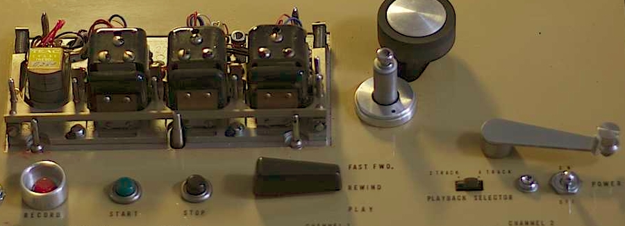

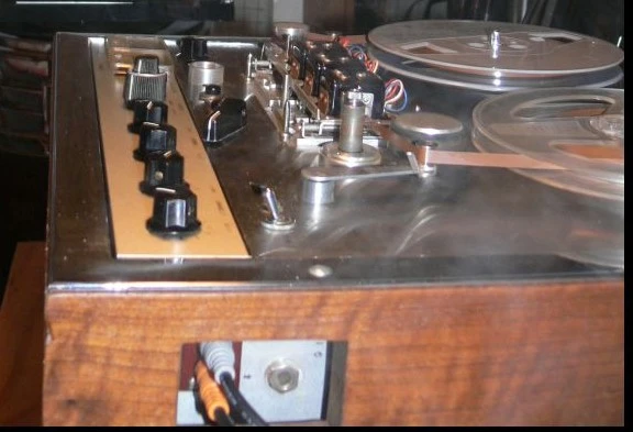

No, many capstan are not overly finished and I've hard rubber that works fine, But it is still the process you describe. This early '60s capstan picks up oxide easily
