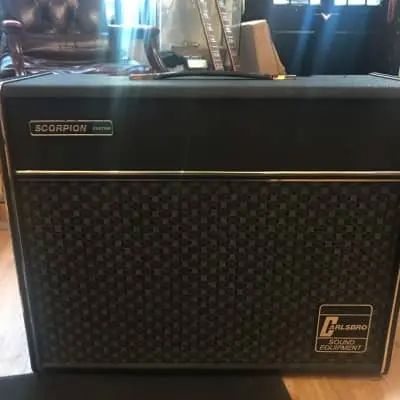

My first guitar amp was a 70s Carlsbro Scorpion 2x12 all solid state combo. That amp was very loud, had twin channel and sounded bloody great overdriven, so yes, you are right, apologies. I forgot about that one Dave ??
