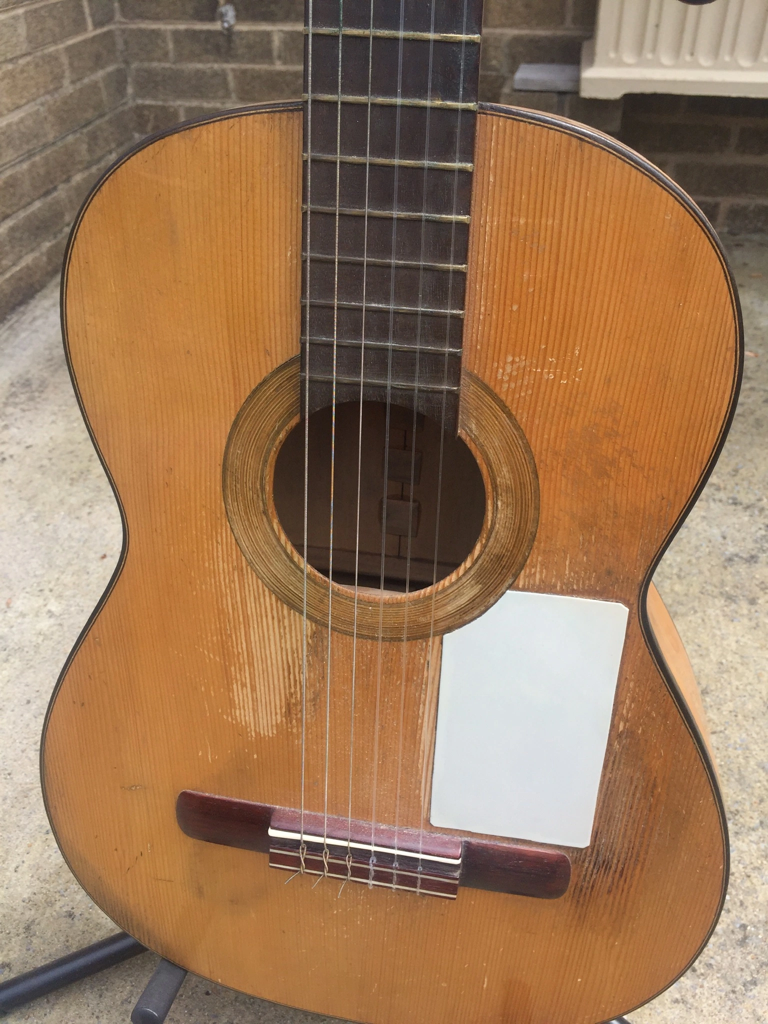

I’m a classical guitar player myself, and I was making a joke. Relax. No need to insult me.
In my experience, a lush, live room goes a LONG way for a classical guitar. Here’s my classical guitar from the 1910s
I’ll also include a recording of one guy I recorded. Tube mic, tube pre, tube/tape sim plugins. Mediocre room. And yet it still sounds good and clean.
Yes, in my experience, the need for a mediocre room and a great room changes depending on what you’re recording
